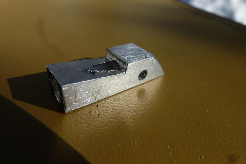

If you want extra weight you could get a NM Ruger steel XR3 grip frame like on the 2005 & 2006 50th Ann. Flattops or from one of the New Vaqueros and make a trigger Spring adapter for it. I would think that it would work. Not brass but heavier than the alloy. .

Posts: 2686
Re: XR 3 Grip Frame
To use a New Model grip frame on an Old Model revolver just make a trigger spring adapter. Here is a picture of a completed part. Basically, it needs to fit in the slot where the NM trigger return spring fits. It has a cross pin hole to hold it in place, and it has the OM trigger return spring & plunger hole in the end. File away any material that gets in the way. Here is a pic of one in the almost finished stage.
New Model frame Old Model Trigger Spring Adapter Save in Documens   duFjM3I.jpg
