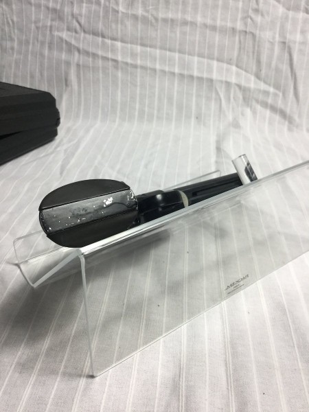

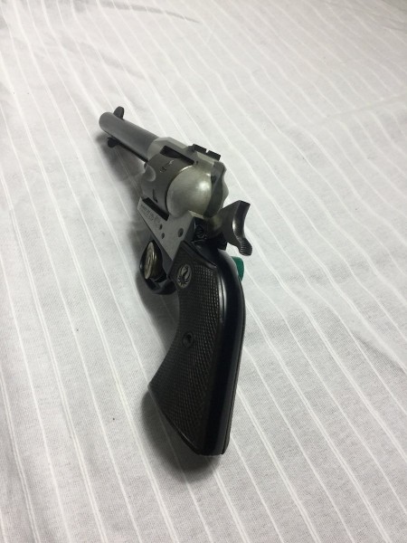

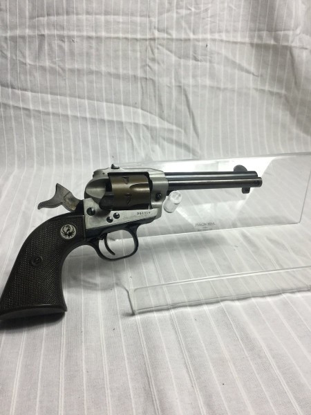

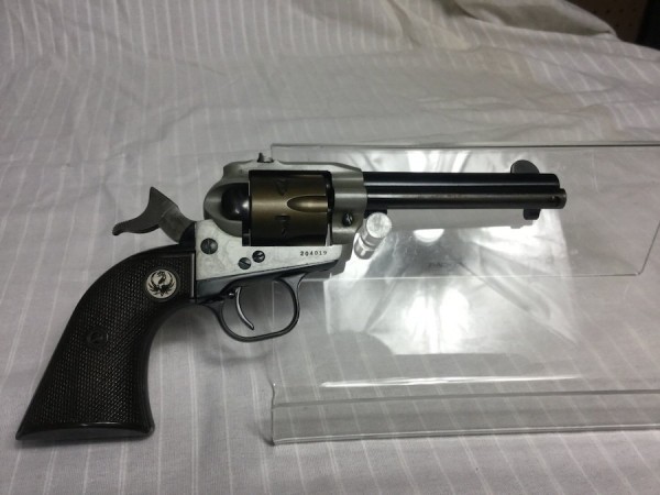

The photos below are of another one with a SN (204019) that falls within the range of Tricolors shipped with the updated ejector rod button. The round gate was added later, no doubt, as the bluing looks pretty bright. The gun is in really great shape except for some nicks in the bottom of the grip frame. There is also a casting flaw right there that I'm surprised passed inspection. I like it anyway. I've made an offer on the gun and waiting to get things sorted.

Chad, can you comment on 204019 pictured above? If it is one of the factory upgraded ejector rod guns does that add value? Thanks, mucho.

The tri-color with large button ejector rod is more scarce than the small button gun, but at this time I don't believe that one brings a premium. You might try getting a letter on it though. I used to have 204948 which was a correct flatgate, but also had 204949 in my notes.... always tried locating that one because it was noted with roundgate and had an appropriate ship date for a round loading gate.Carbineguy wrote: ↑Sun Oct 25, 2020 1:28 pm Chad, can you comment on 204019 pictured above? If it is one of the factory upgraded ejector rod guns does that add value? Thanks, mucho.
