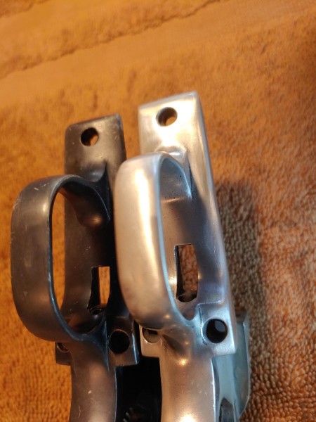

Here's a pic:
XR3 grip frame & trigger variations

I'd thought this would have generated more comments. So, I changed the title to more accurately reflect the topic and I'm posting a photograph of the trigger slots on the two frame styles. The unfinished frame is the later, small ALCOA G, variation. Note that the bottom view shows that the later, thick trigger, opening is longer there, mainly due to a more severe "ramp" cast into the front of the slot.
Have I overlooked something? I hope to get educated if I'm off the mark.

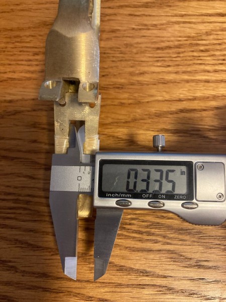

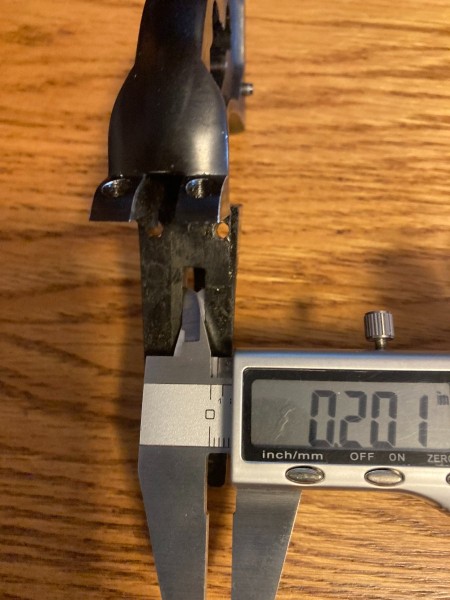

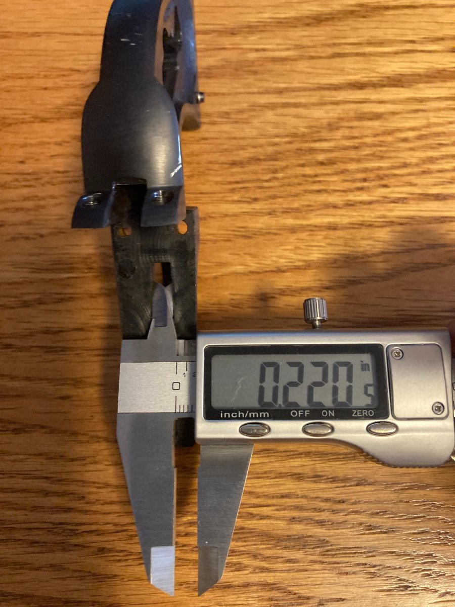

I dug through my loose grip frames and all the XR3 were the small G with the one exception already opened up to use a target trigger, so I didn't measure it. The three pictures below are XR3 small G, XR3-RED, and unfit Brass Frame.
Re: XR3 grip frame & trigger variations
Great info Troy, thanks for posting.
Yes, thanks, Troy.
