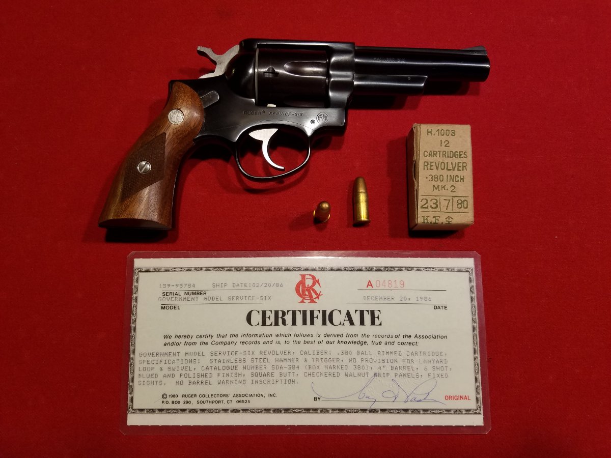

My SDA-384 is another Service-Six marked high back Government/Foreign but falls in a much later serial number range 159-95784, there has to be some more out there, here's another pic of it.

Bennett,
You are correct, remember it's been awhile since the last update to the RENE. That's why it is important to keep reporting
data to Chad so that he can record it. Also if there are over run guns from a Foreign Govt. Contract, or a US Govt. Contract
those guns would bear the same roll mark. IMO
