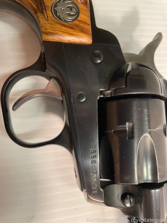

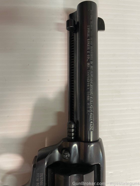

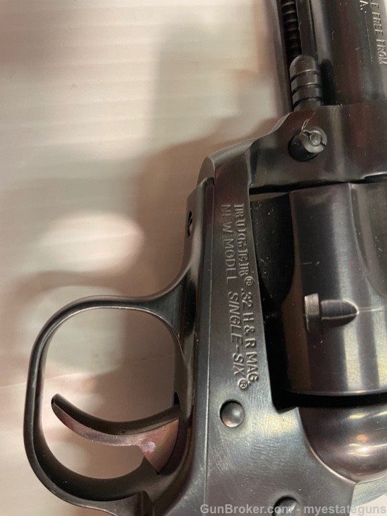

Just snagged this on GB. Could be a re-finish but it doesn't look like it to me. Sure would appreciate having all your expert eyes on these seller photos. It was shipped in 2000. i
Posts: 1116
Re: SSM4FI (6509) ALL BLUE?

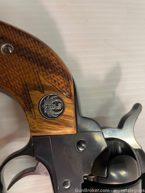

Looks good to me! I don't know about the checkering on the grips though, can't recall Ruger ever putting grips out like that.

The grips are wrong - should be wearing ivories. But was the frame ever case colored?
Never seen a turn line quite like that.

Looks like the cylinder latch isn't coming down enough. Just enough to come out of the cylinder notch but not enough to clear the cylinder completely. Possible cylinder latch problem or hammer problem?
Doesn't look to me to have been refinished, writing is sharp and no dishing out of the pin holes. Or the refinisher is VERY good.

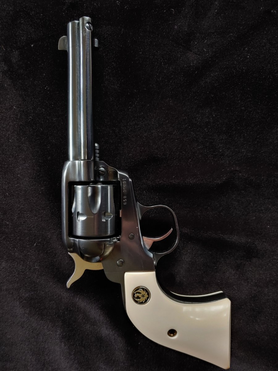

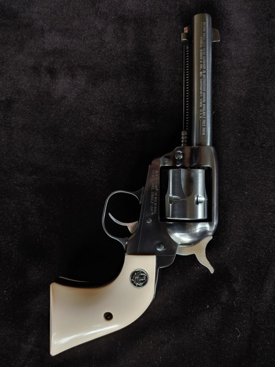

Ruger Records says that this gun was shipped as case color/blue so who knows. Doesn't matter. I like a blue fixed sight thirty-two. I put ivories back on it after cleaning it up. The serial numbers are scratched on the upper right inside of the grip frame and on the underside of the ejector rod housing, which has a higher polish and deeper blueing than the rest of the gun. Could that indicate a factory refinish?
