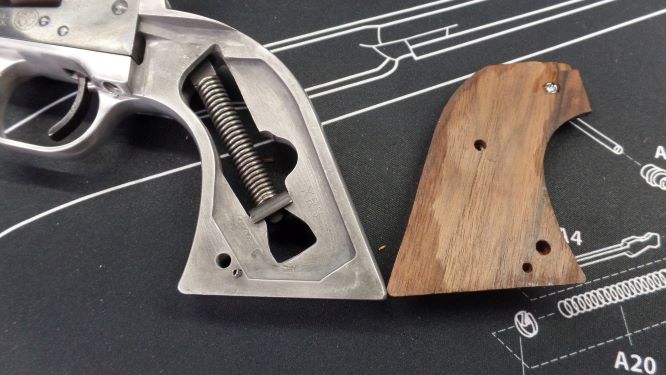

Here is another picture with the grips off. I was unaware that
the grip locator nub on each side of the grip frame was a pin, since
this one has been removed.
Another hole was drilled in the grip frame and a roll pin put in to
hold the newer style grips.
I'm going to pull that roll pin out and put another back in the original
hole so I can put some grips on that fit correctly.
