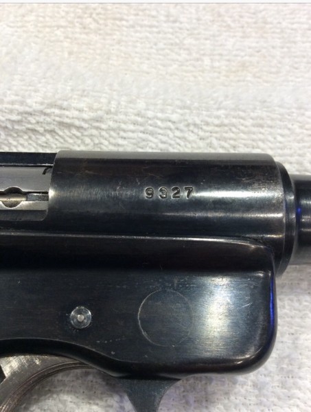

Rickkling
Posts: 100
Location: Pelham, Alabama
Re: A little help for a newbie please
Post by Rickkling »
Well, let me start by apologizing. I did make that question a bit vague!
My question was how to tell if it is a 2 piece medallion. It doesn’t seem obvious to me.
The serial number is 9327, which chad hiddlesons book says has a 2 piece medallion.
I haven’t taken the grips off, so I haven’t looked at the backside.
I have no idea how to post pics on this site, but I’m sure I could be walked through it.
Thanks for the responses

theo98
Posts: 66
Location: SE, La
Post by theo98 »
RL,
You should have a Ruger Pistol Red Eagle Type IV (one of the rarest) with either the 1 or 2 piece grip medallion and a flat muzzle, mnf. Oct, 1950! :mrgreen:
Does the Red Eagle appear flush with the medallion silver background (2-piece), or does it appear recessed into the medallion (1-piece)?
Bill's "post pics" directions also works for me (max "5" per post)! ;)
Ted
"FREEDOM Is Not FREE"!
Rickkling
Posts: 100
Post by Rickkling »
Thanks bill and ted! (Ill spare y’all the movie references!😊)
I only briefly “fondled” the gun before putting it in the safe, but I do remember the emblem being smooth compared to all the other ones I have. You can feel the indentation in those.
Im at work now, but I can confirm tonight
These are pics I took for my records. ( they are blown up screen shots, but decent none the less)
Thank you again for your help guys!
Rick
theo98
Posts: 66
Location: SE, La
Post by theo98 »
Yep, and the Adventures Continue! :roll: :lol:
Rick, Looks to me that you do have a Type IV with the 2-piece medallion (flush Eagle, edge yellowing). Great pics, looking forward to the big enchilada (err, Ruger Pistol pics)!! :mrgreen:
