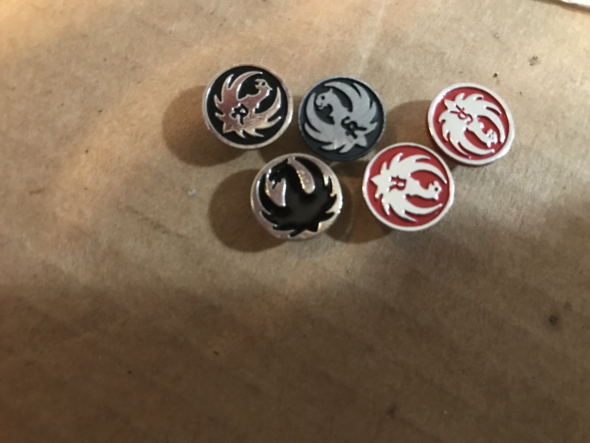

These are the only versions I have been able to accumulate so far. Think I have another version on the way to me in the mail. I think there was a gold colored version for a special issue SA?

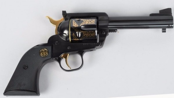

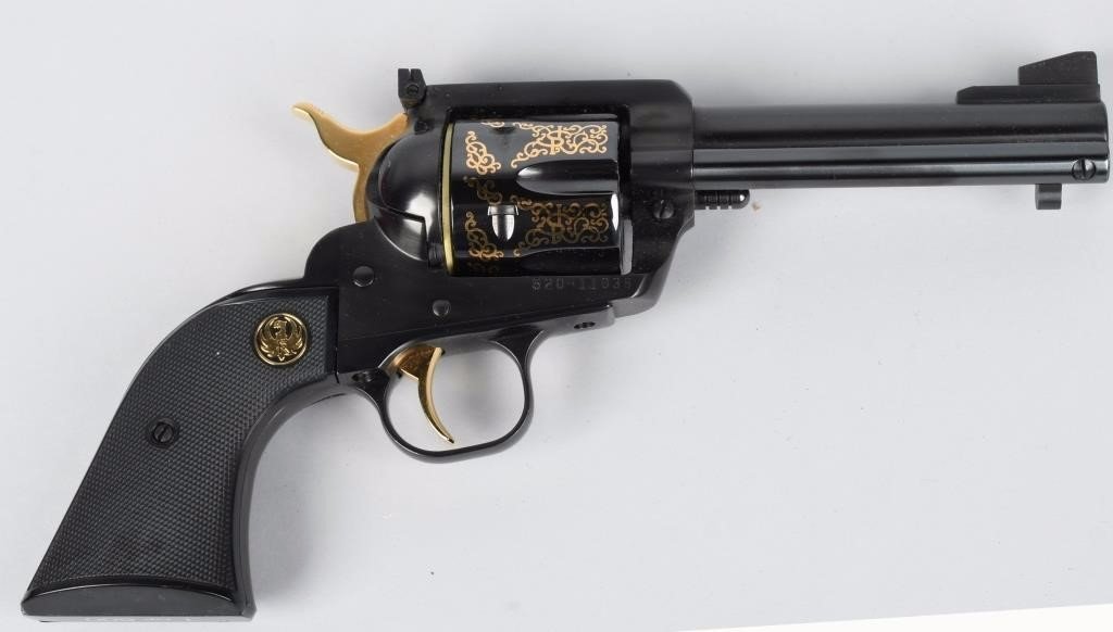

Found the gold tone medallion
https://milestoneauctions.hibid.com/lot ... -blackhawk

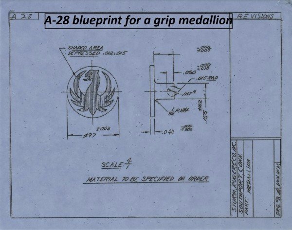

Posts: 656
Re: Medallion colors
The only thing I have is a doc Don Findley shared in one of his books. Was it the Sturm book? This blueprint initialed by AS. Sure you are right about the evolution to other designs. Don may know something about whether contracted or in-house production?
Posts: 912
The "AS" would be Alex Sturm.
It would be interesting to do a measurement on the thickness of the earliest sunk in red eagle medallion as compared to the later medallions. The earliest sunk in medallions for the red eagle were very thin, and staking the stem on the ack of the medallion would more times than not, push the center of the eagles chest outward, sometimes even braking the paint. This was fixed sometime in early black eagle production to a thicker medallion.
The very first red eagle medallions pre-dated this blueprint as they were two piece brass medallion and stem, with the stem brazed to the backside of the medallion and the red of the eagle enameled flush with the surface of the medallion.

well there is NO "historian" Chad is about the closest we'll ever have to that,,( you're welcome Chad) and the picture of Bill Hamms shot there are "variations of each of the ones pictured along with many other , speckled finish silver, squashed chickens, and yes the browned ones that were NEVER silver when the left the factory on the mid 70s...and as I said earlier above let alone the variations of the BLACK eagles , and the neck sizes, feather tips numbers, and on and on...the drawing (AS) is what they wanted, the vendors sent what they actually made up, and each one did it differently........wish I had taken a picture of every varient of the medallions over the years,,,there are MANY<,,,go look at the books as I suggested........
here is a picture I found of some "basic" ones, author of this picture unknown........

rugerguy wrote: Tue May 11, 2021 5:29 pm ...the drawing (AS) is what they wanted, the vendors sent what they actually made up, and each one did it differently.......
- so in theory then, every medallion style except one, may in fact be a "close enough for a Ruger" non-compliant design accepted by extremely flexible purchasing and recvg. Inspectors... Hmm...
