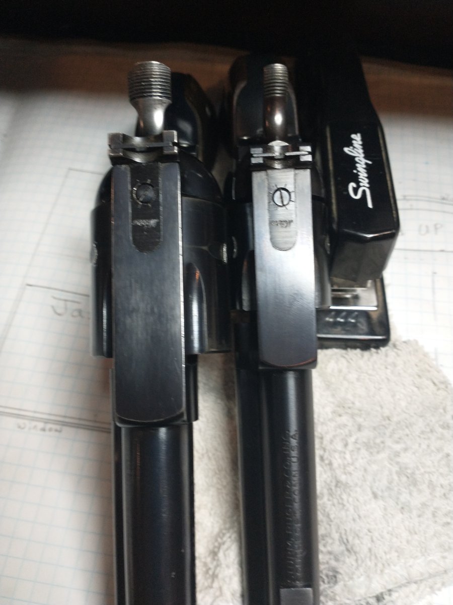

I have a flattop 44, early 5 digit serial number. I have been a tool & die maker , machinist over 35 years. I have been comparing these guns side by side. Machine marks on the front of the frame are exactly the same. The frame on the single six is smaller. The rear sight is the same rounded front, same as flat top. Not square like the super single six that it serial numbers as. If ears were cut down on a frame with the ears , pin would break out of frame , besides being round, instead of square. Where 32 cnp is stamped, frame is same thickness dimension as my 44. Either Ruger had this gun made for someone. Which I don't really think???. I would have to imagine that a employee would have made it out of Ruger parts at the plant & had it stamped to what he wanted it made. I'm open to any better suggestions.

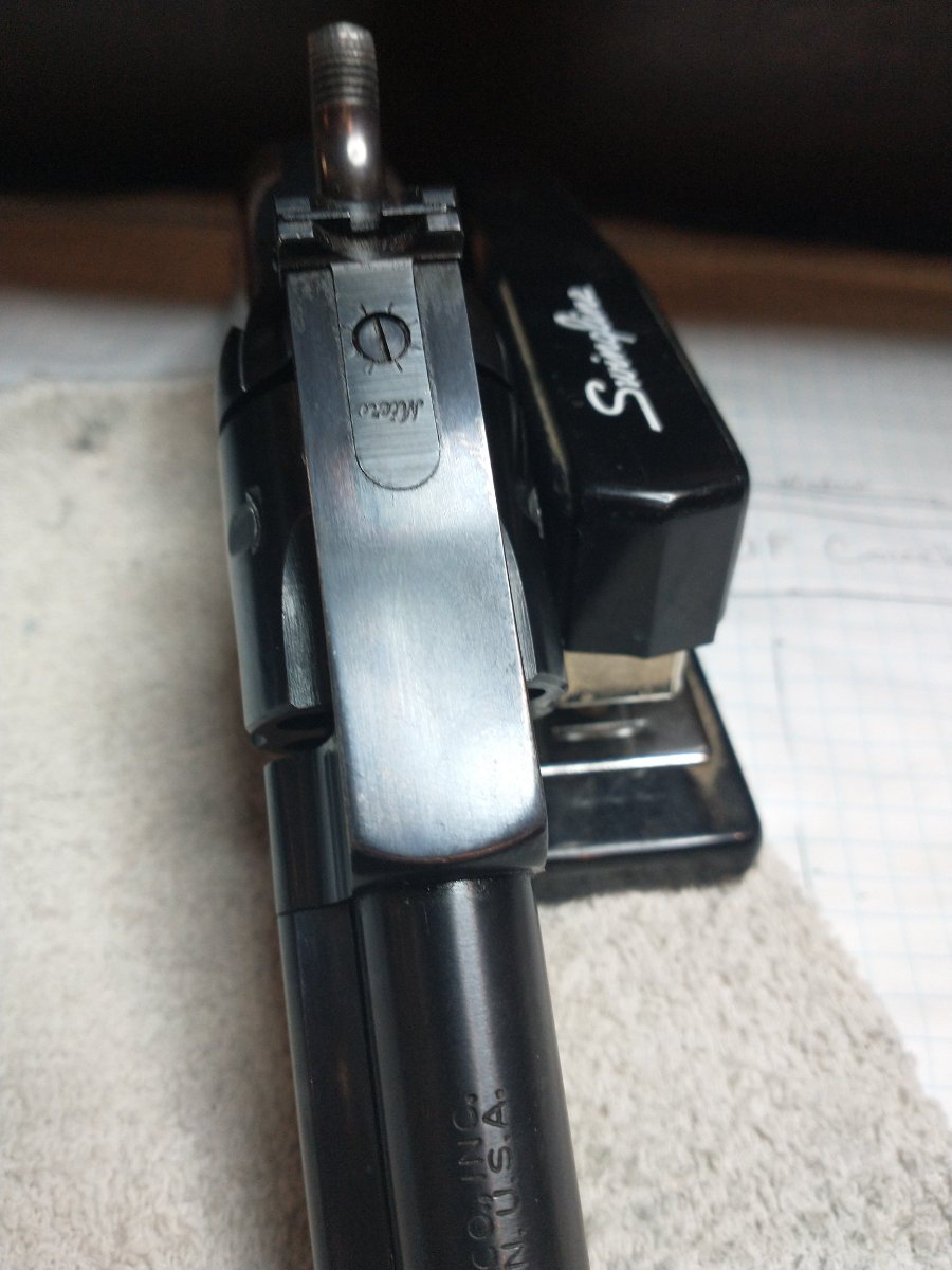

The CNP looks handstamped to me.
Can you show a pic of the topstrap with the rear sight? Not sure why Ruger would make a flattop after they intentionally discontinued the flattop Blackhawks 5 years previous to this gun being made.

It's not on a Blackhawk frame. It's scaled to single six size, but no single six had round micro sight. Possible that ears were cut down on super single six, but they didn't have the old style round rear sight. It's like someone intentionally made a gun part old style & part new style. Barrel & front sight are right for a super single six. No one other than a Ruger employee could have roll stamped the lettering in the frame except at the factory. Frame thickness hasn't been ground down to accept new lettering because it measures the same thickness as my Blackhawk. Blackhawk on left, single six on right. Don't pay any attention, my Blackhawk has a wide hammer installed.
