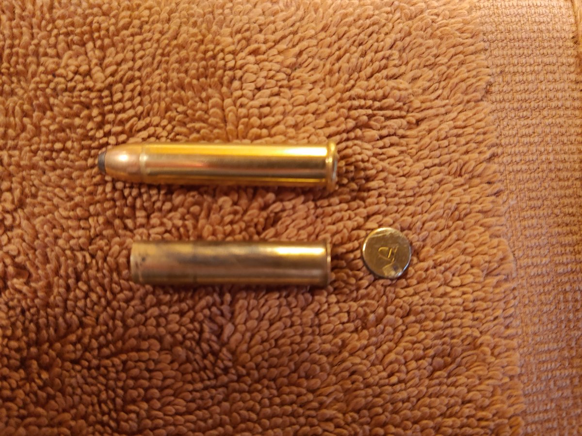

Finally made it to the range yesterday and it looks like I bought someone's headache. Started out shooting really well but then light strikes started happening - seemed like it happened only on the last round in the magazine but that must be coincidental. Accuracy at 50 yds was not bad but I didn't get check it at 100 yds because round no. 35 failed to eject and no.36 stove-piped and ignited in the receiver. The case head separated and I couldn't find the slug. No damage or injury but so glad for eye protection. So, the stories about ejection failures with the single-ejector bolts are true, I guess, and now I have to switch-out the firing pin and ejector. Any recommendations on parts? Never mind, I have found what I need here.

Here are photos of the targets (top one is sighting in and the bottom is 3 groups of 5) and the case and ammo. Shootus interuptus didn't help accuracy. The 40 gr bullets should be fine

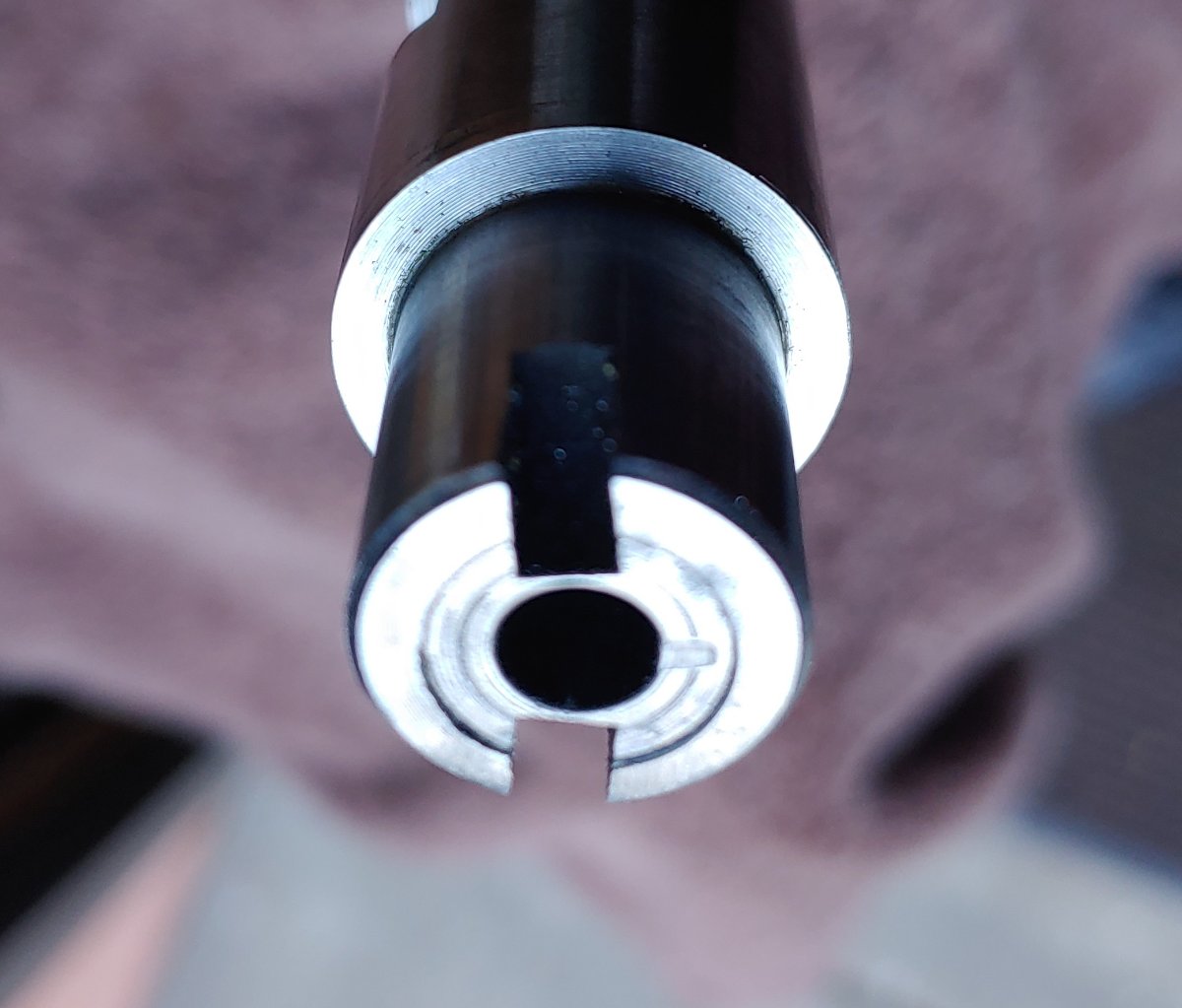

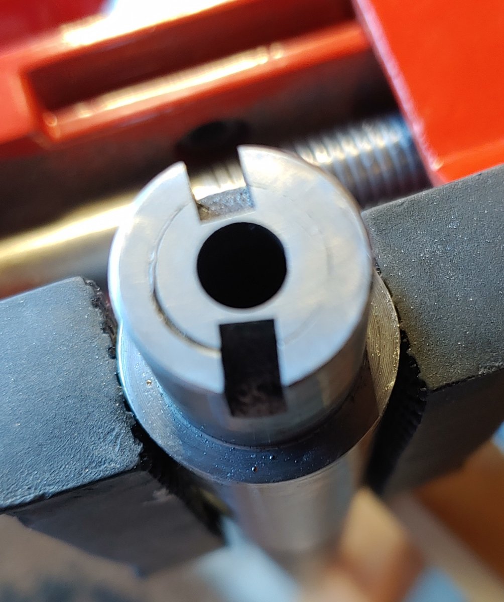

Finally decided that the problem might be the chamber face and, indeed, the barrel had a chamber-end that was not totally flat - the barrel tube ran past the chamber sleeve ever so slightly on one side. I figure that surface ought to be flat, even and square to the barrel so I took some material off with file and stone (see before and after photos).
I don't think the heads on .22wmr ammo are all that robust - and they seem to dome slightly when fired, which pulls the rim edge in making it harder for the ejector to hook it. So the correct clearances are super critical and a bumpy chamber face would cause problems. That's my theory, anyway.
I took only enough off to make the surface flat because I didn't want to over-shorten the chamber. A round still seats fine so it might even improve accuracy.

Owen,
I think you might have figured it out.
From the pics it looks like the part of the sleeve sticking out was at the ejector slot, so now the ejector will be able to get farther forward and catch the rim of the cartridge better.
Let us know how it works...... 8-)
Jay

I sure hope you're right, Jay.
It looks like VQ left a little raised ring around the chamber, which may have been their solution to extraction problems. If so, the barrel should have been accompanied by a no-dry-fire notice because there's a FP indentation visible in the before pic. I think the main problem was the tube was not square with the sleeve. Nice and flat, now. We'll see.
