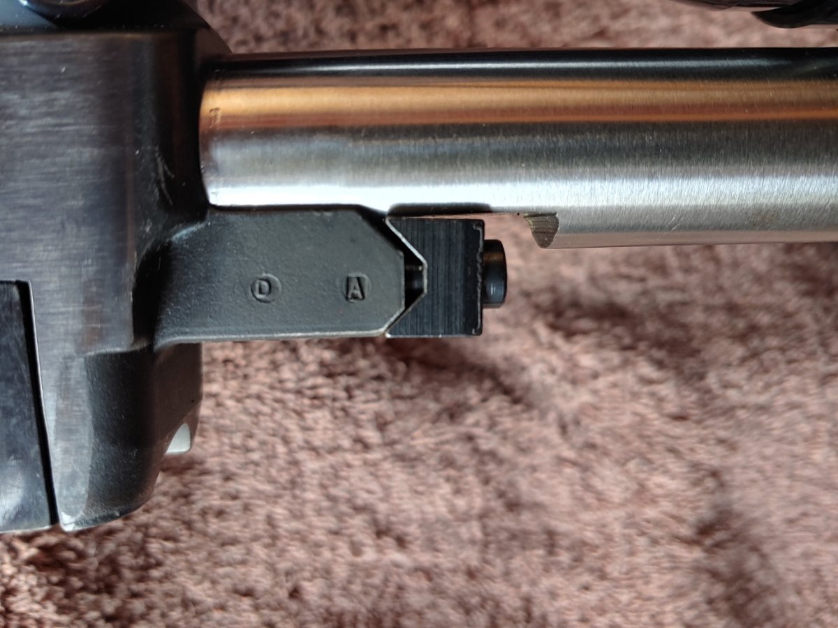

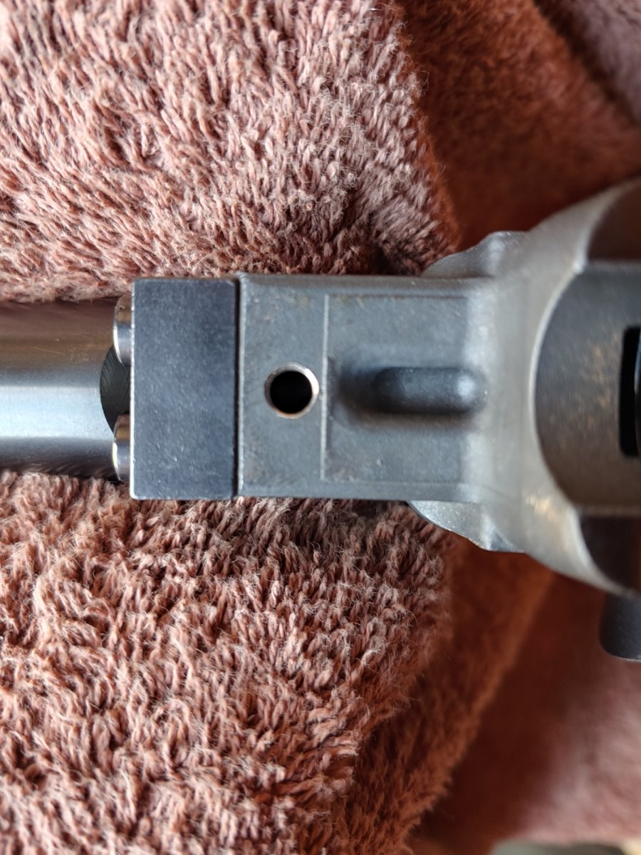

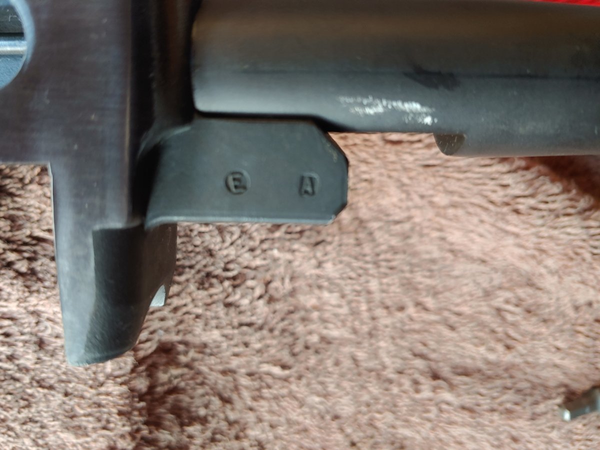

I found another donor gun for my original concept project. The first one is back in the Hogue stock and going out the door. This one came with a factory stock and barrel but missing the band. It is SN 290-29554, which puts it as a 2001 date of manufacture and it carries the double-extractor bolt. As you can see, the receiver casting is better where it meets the stock with a well-defined deck. The casting marks are also different - the earlier gun has a D in a circle and this one has an E there.

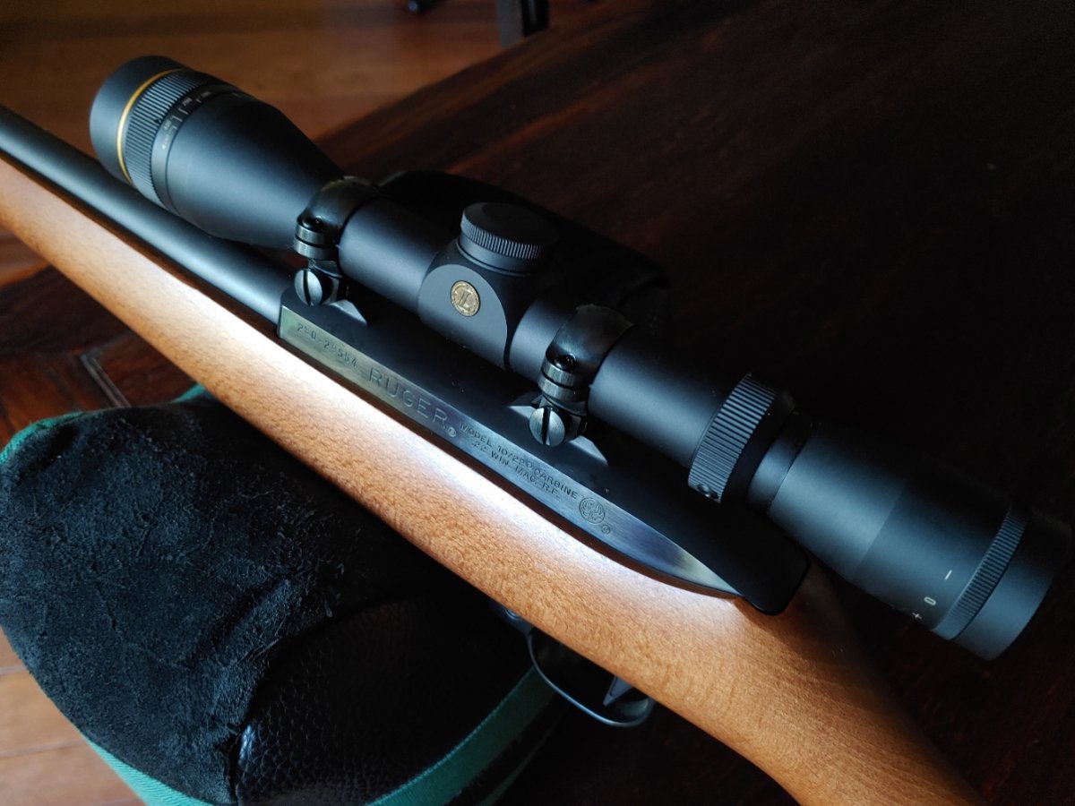

Here is my original concept with the fjfeddersen barrel and a Leupold VX 2, 3-9 X 33mm Rimfire EFR AO scope mounted in Leupold/Ruger low rings. The rings are actually lower than comparable factory rings and put the optics in a perfect position for me. As noted elsewhere they are also smaller, lighter and nicer looking. Some photos:

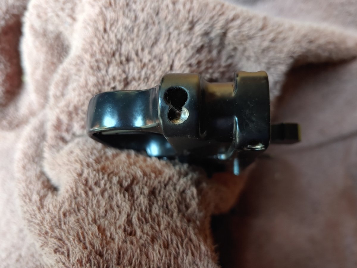

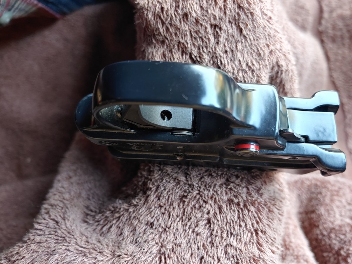

Another interesting bit is that it came with a trigger group from a company called Brimstone that is completely unique. The factory trigger return has been removed with the hole drilled-through and threaded for a set-screw trigger stop. Their trigger return spring is on the trigger pin and there is an additional threaded hole on the left side above the logo with a set-screw in it that may be part of that mechanism. I haven't had the energy to take it apart, yet. Must have been a costly upgrade but trigger pull is amazing and I'm glad to have it

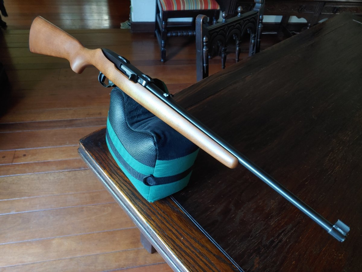

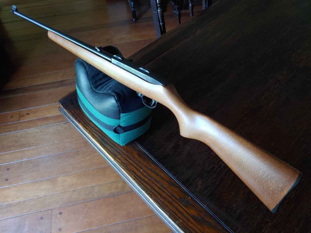

I made up a factory-barrel Sporter just to see what it would have looked like.
Some photos:

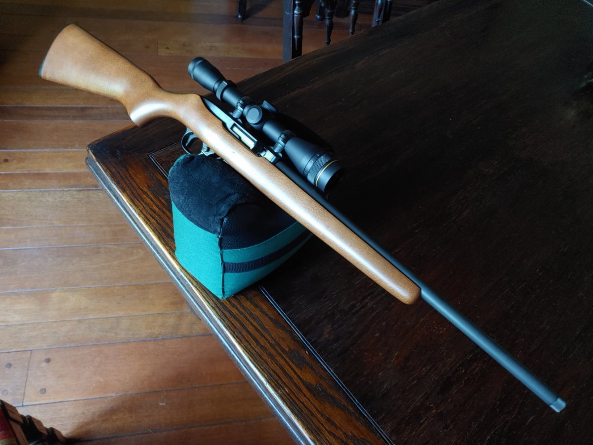

I took this one to the range recently and everything functions well and the accuracy was about the same as the one with the Volquartsen barrel; 3 inches or so at 50 yds. I'm going to try some Federal 40 gr fmj target ammo.
So, I already had this new FJF 16" fluted bull barrel and I just had to put it together with the Sporter stock that I stripped and opened up. I think it looks much better in this combination. Some photos:

Well, boys, my eyes are certainly going funny and I suspect they're tired of working after all these years. That and rushing a short range visit, trying to do too many things, may have contributed. I've had good results with Fiocchi ammo in other calibers; maybe it's the "indoor range" bullet.
I like the contrast of the lightened stock finish against the blued barrel. It's handsome and unique though a tad heavy.
