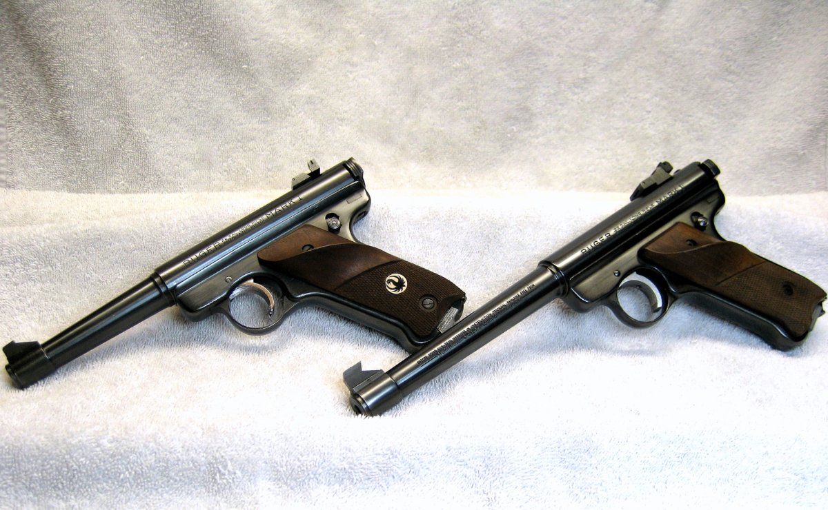

WT,
Yes, this T514 has a 2-piece Tapered Bolt Bottom Arbor! Side views give it away, as the 2-piece tapered has only "4" ribs to grab on the bolt pull back ears. The single all-in-one piece non-tapered bolt has "5" evenly spaced ribbed ears to grab, such as my T678!
Ted

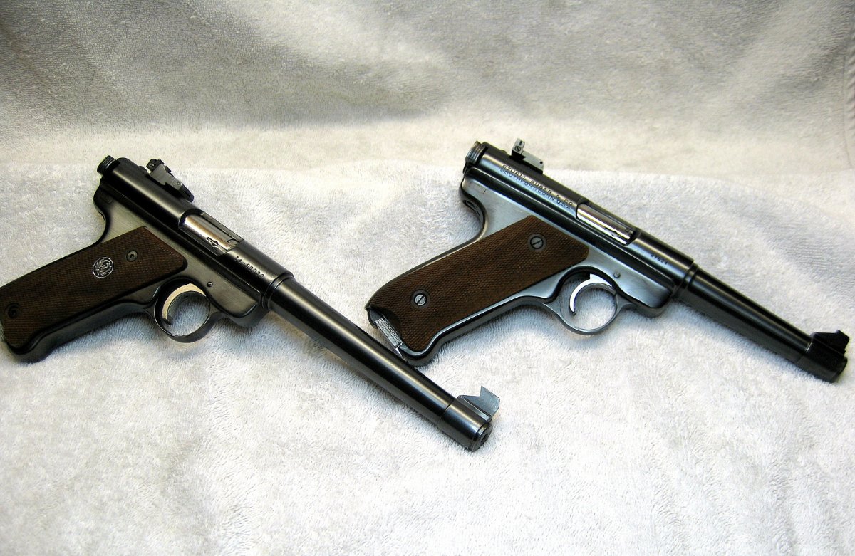

My MkI Family pics (T514 dressed w/target grips)! :mrgreen:

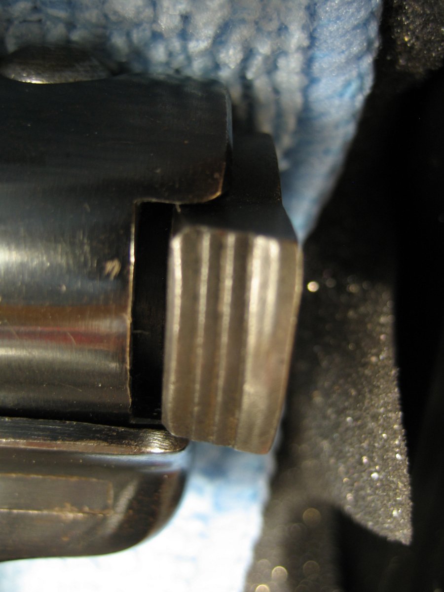

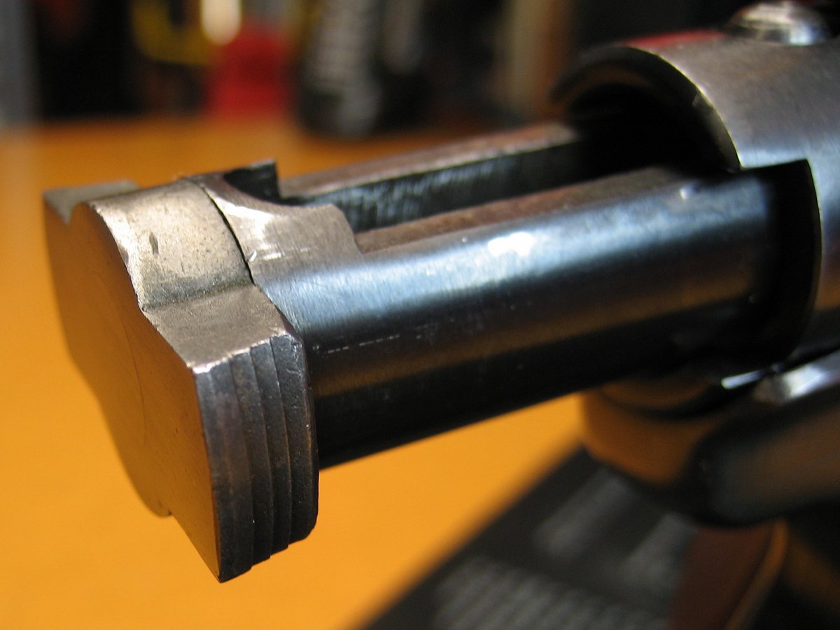

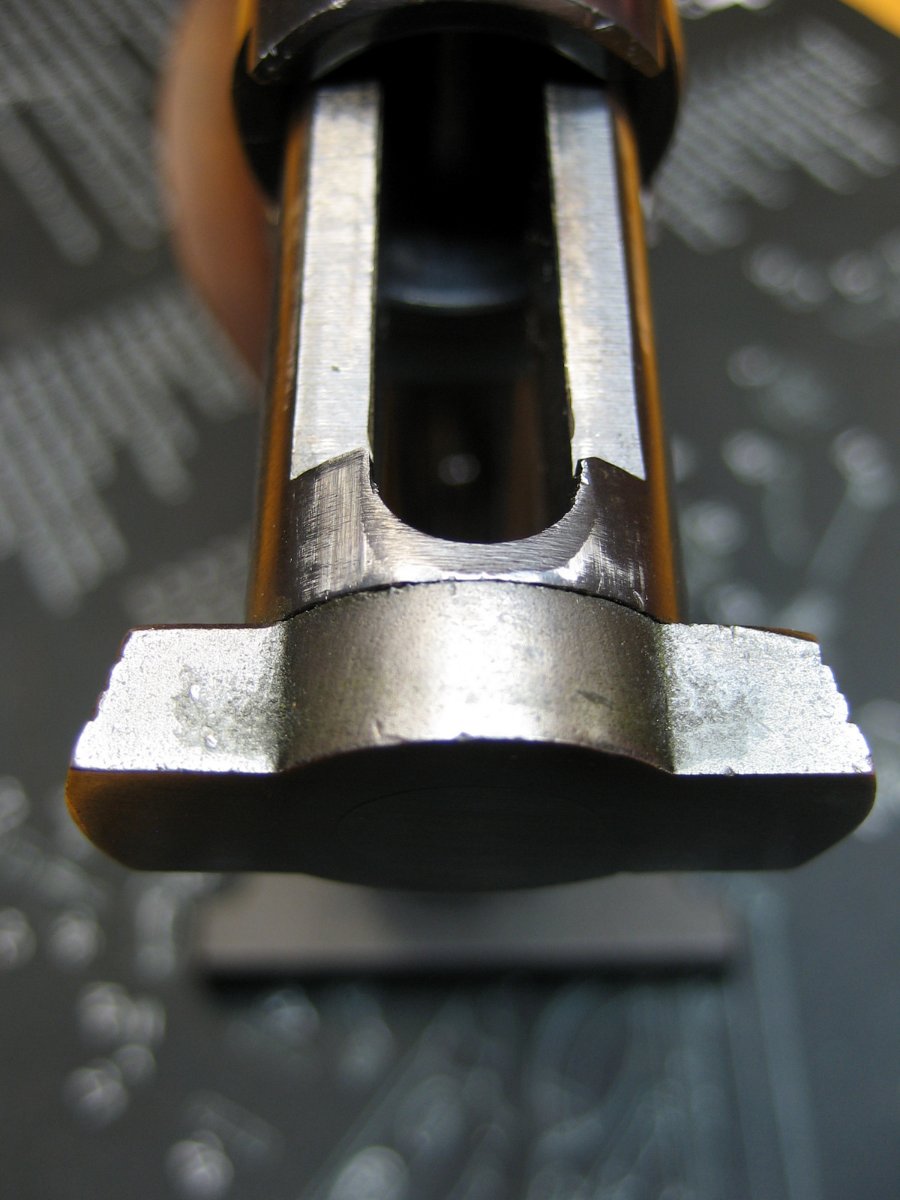

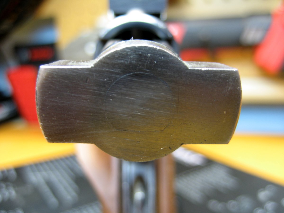

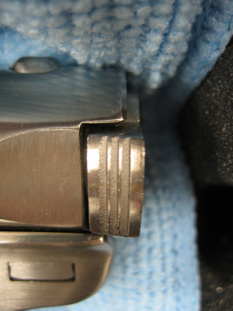

jowdurt wrote: ↑Fri Jul 17, 2020 8:00 am Is it possible to have a tapered bolt that is only one piece. The dead giveaway for a two piece bolt is the "D" shaped imprint on the back of the bolt. A picture of that with the right light angle would verify it is a two piece to me.
Steve Vaughn
Steve,
I'm not sure if "1-piece tapered bolt ears" exist, but seems I've read before it does?! Hopefully another member can verify one way or the other. :?:
In my collections, all three of my 4 ridged tapered bolt ear Rugers are 2-Piece, display the typical attachment seam between the cylintrical bolt/ears and have the typical "D" shaped arbor appearing on the back of the bolt [53' T514 (1st 3 pics), 53' Standard (4th pic), 86' SS Standard (5th pic)]! :!:
Ted

That is great info and even better images of the two-piece bolt. Exactly the type of info I was looking for. Good job highlighting the D shaped machining on the rear of the bolt.
Thanks theo98.

theo98 thank you for posting the tapered bolt pictures. I can see where the repeated firing would seperate the 2 pieces. A friend of mine has an early vintage KMK4 that ended up with bolt failure. Ruger repaired it for him and he is happy with the results. I was not there when the bolt failed but can imagine the look on his face as the ears popped loose.
