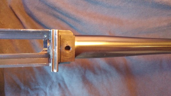

Having already installed bolt shims, a Volquartsen target sear/spring and shimming the trigger and sear pins, I had to get into the stock and mounting hardware. The action looked slightly canted and the barrel was not lying straight in the channel. So it was probably quite unruly though I did not have an opportunity to shoot it.

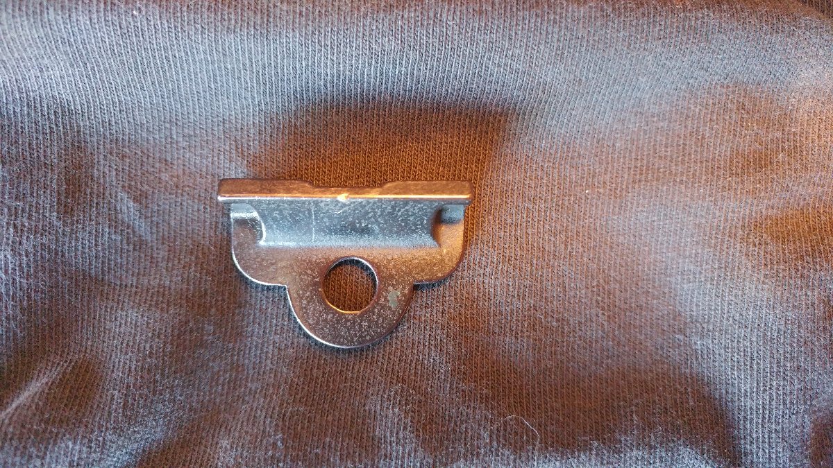

Inspection of the mag liner revealed a small divit in the edge that fits into the groove along the bottom of the recoil lug. It's the little bright spot in the photo.
The culprit was a high spot in lug groove where a casting line crossed it causing the two surfaces not to mate squarely. You can still see it after careful work with a triangle file.

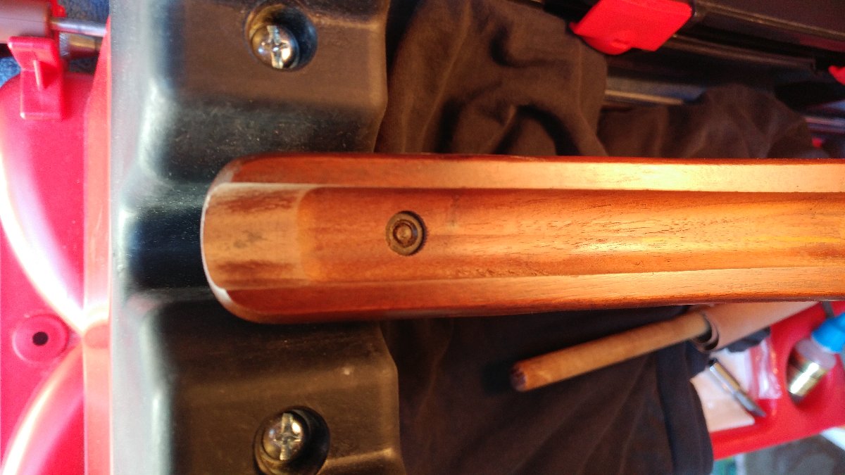

There was evidence that the barrel had been bearing on the channel too heavily. With a dowel wrapped in 400 grit sandpaper I slowly removed material until the barrel rested lightly in the center. You can see the channel in the bottom photo.

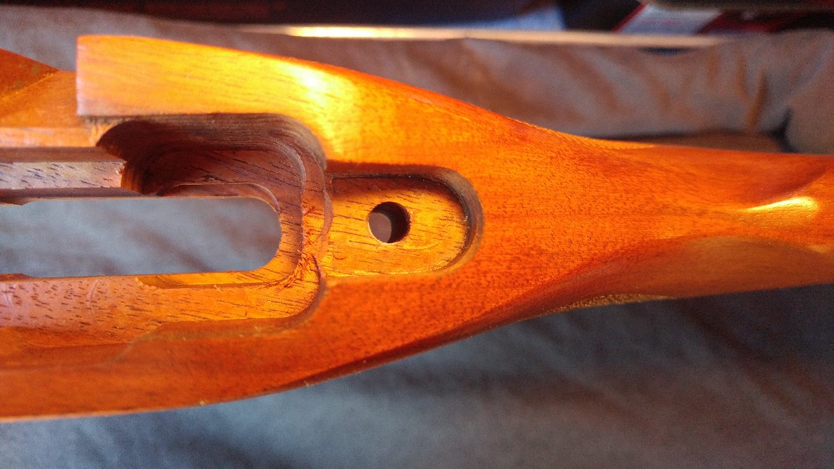

I also checked the the wood surfaces behind and above the recoil lug were flat and smooth. Here is the lug contact point before.
Finally the area underneath the tang looked like it extended too far forward and was binding on the bolt release spring where it clips under the tang. Before and after a little work with a dremel photos are in a following post. Getting the hang of attachments.

Kinda screwed up the attachment thing in the OP. Here are the before and after of the tang area. I hope.
Hmmm. I get a notice about permission but I think it worked
BE CAREFUL not to remove too much material from the channel. You just want to level it to the barrel. GO VERY SLOW.

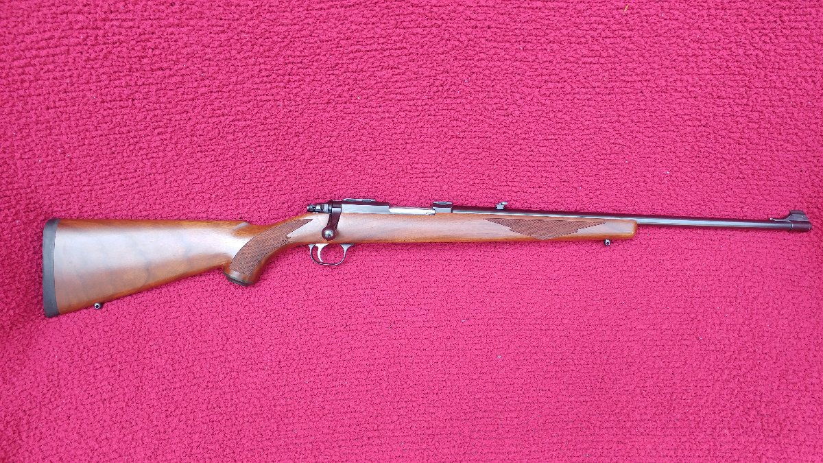

Here's the rifle I've been working on.
All fixed up and nowhere to go.
