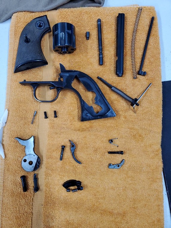

I am slowly going through a bunch of guns I bought in 3 collections and are running into some challenges. I have a 4 digit flatgate, that has the hammer stuck on position 3.
It goes to full cock and then when the trigger is pulled stops at the next click. So I finally took Jerry Kuhnhausen's book and followed the disassembly instructions. I am going to attach the picture of my "field of parts". It seems that all the parts are present, I don't see anything obvious (like a smoking gun :o ).
I also compared with some conversion parts that I received with some other guns that had transfer bars installed (mainly two LW's made in 1956 and 1957) which are close to my gun in question, which was made in 1954. All the parts seem to be the same and interchangeable with my 1954 made Single Six. Does anyone have any suggestions as to what I need to look for?

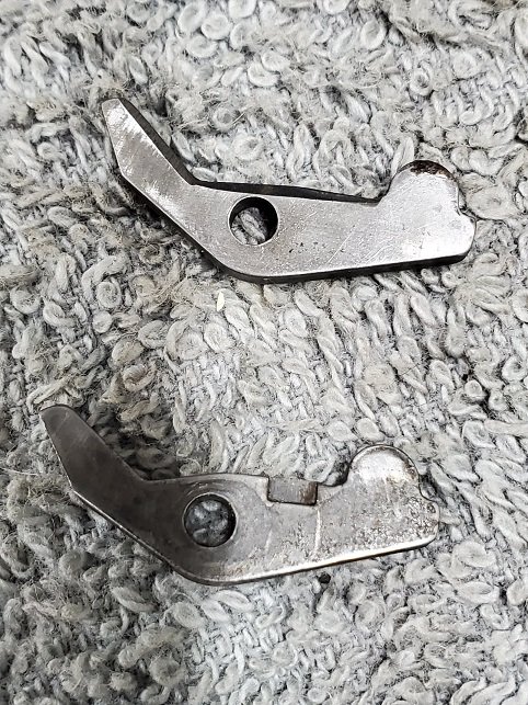

I suspected the cylinder latch and tried out two other latches from returned parts kits for guns close in vintage. The next picture shows the latch that came with the gun on top and the one below that belonged to a 1957 lightweight. The lower one has a cutout, it looks different.
I also tried a latch from a 1956 lightweight. Every time the hammer gets stuck. I am not sure what to do next. I have another two 4 digit guns that work perfectly. I could take them apart to compare............ but on second thought, maybe not.

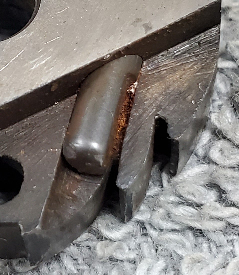

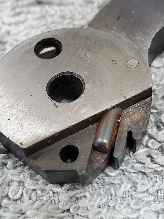

I think I found the culprit! I am not sure if you referred to it earlier or not, but this little plunger is frozen in place and does not move back into the side of the hammer as is the case with the other sample hammer I pulled.
I tried to break the bond, but it won't budge. I applied PB Blaster and will wait to see if I can convince it to come out. I suspect that this plunger and the spring that must be behind it will need to be replaced.
Here is hammer:
Here's the plunger in detail:
Is this the likely problem?
