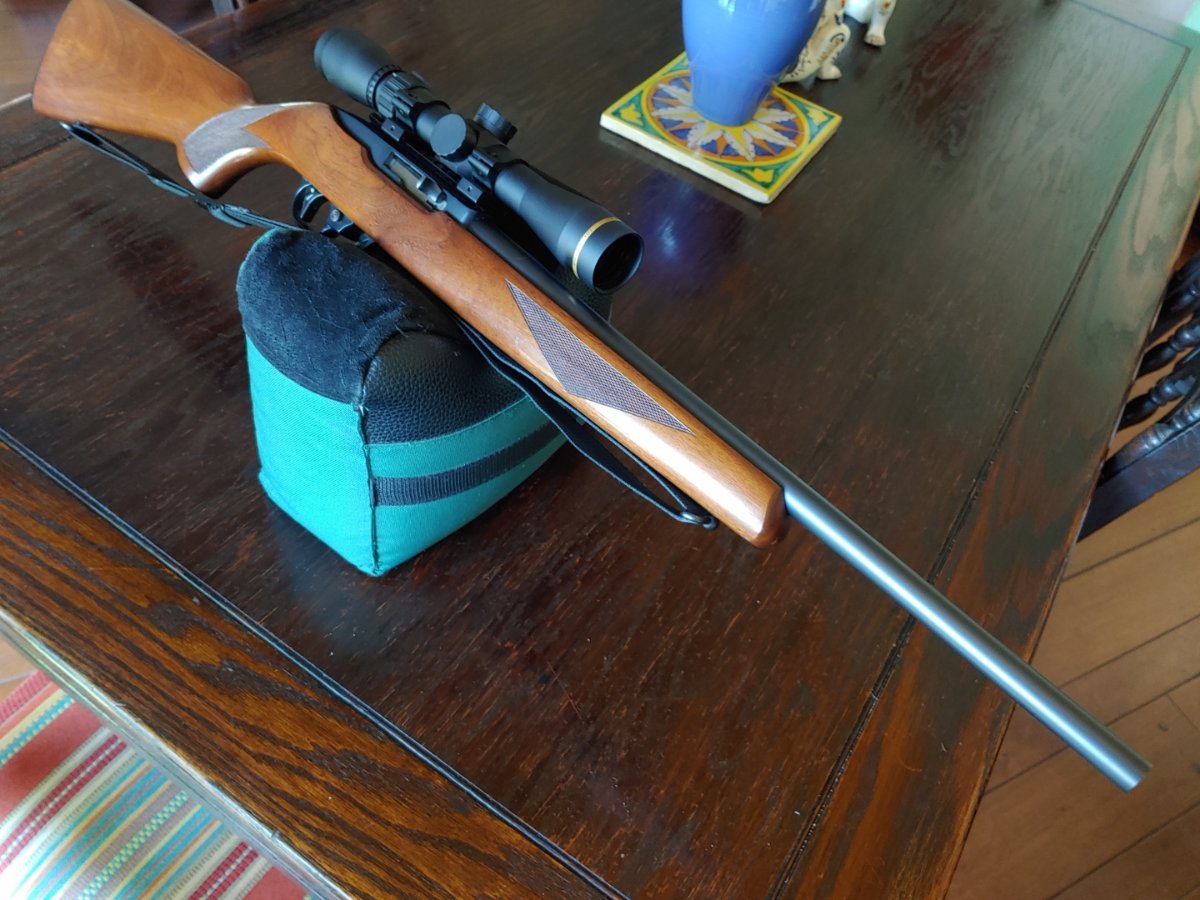

Built this straight shooting Sporty on a 1971 DSP. It has a full Volquartsen kit and an F.J. Feddersen match barrel with a Leupold VX Freedom 2-7x33 Rimfire scope. Shot a ragged hole at 50 ft with a 4x centerfire scope and match ammo. Hope to get to the range again soon for a proper 50 yd report with this setup. Great handling gun.

The barrel has a really nice finish. Here are a couple photos:
CMP Rimfire Sporter match rifle

Very nice rifle. The fact that it shoots that well makes it even better. I checked out the barrel website as you suggested. Very interesting style of rifling. Seeing as how it is very accurate with soft lead 22lr ammo. I have to wonder if it would also work well with cast or swaged led bullets in center fire rifles or handguns??? Just thinking.

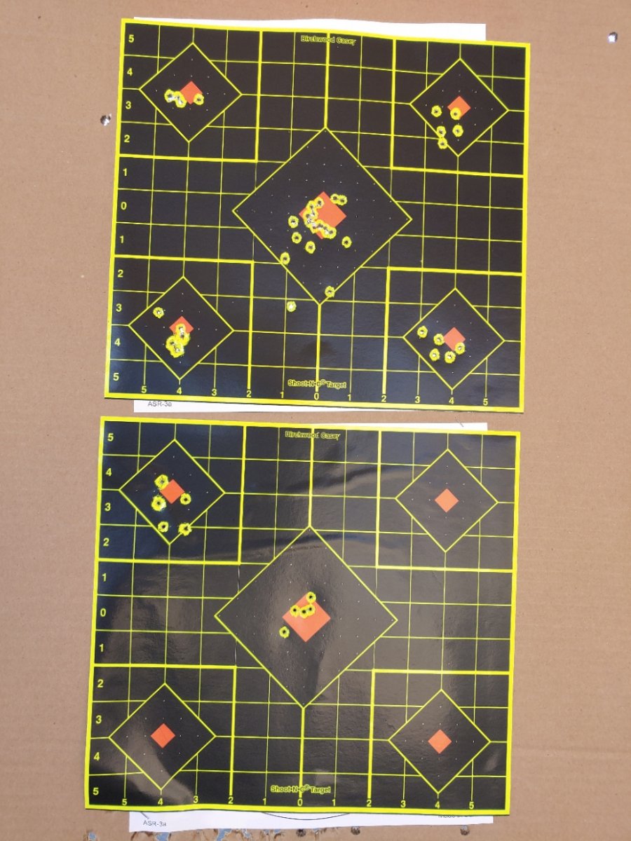

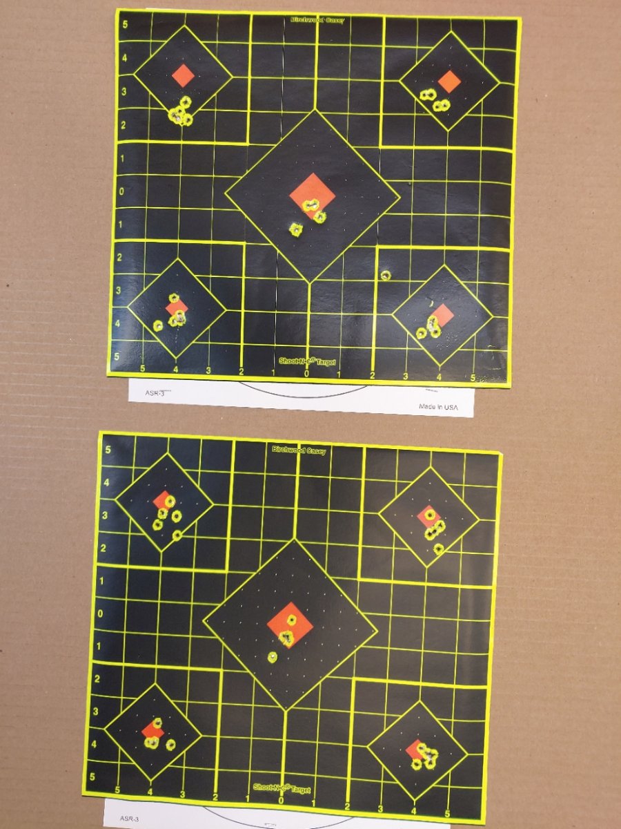

Took it to the range a couple times. The first pic is a rushed sight-in at 50 yrs and 4x optics from a bag rest with SK High Velocity Match ammo. The second photo was the same set up at 7x optic. The top target was with SK HV Match and the lower target was Lapua Midas X. The outline squares are one inch. The rounds look identical and the results are similar. It was a hot morning with sweat-gets-in-your-eye conditions.
I'm having some fail to fire problems because of light strikes. When a failure occurs the round will not eject but ejection of fired rounds is good. I think I may have a worn firing pin. But instead of just replacing the FP I wonder if installing a match grade bolt would offer any improvement in accuracy? Not too bad the way it is.

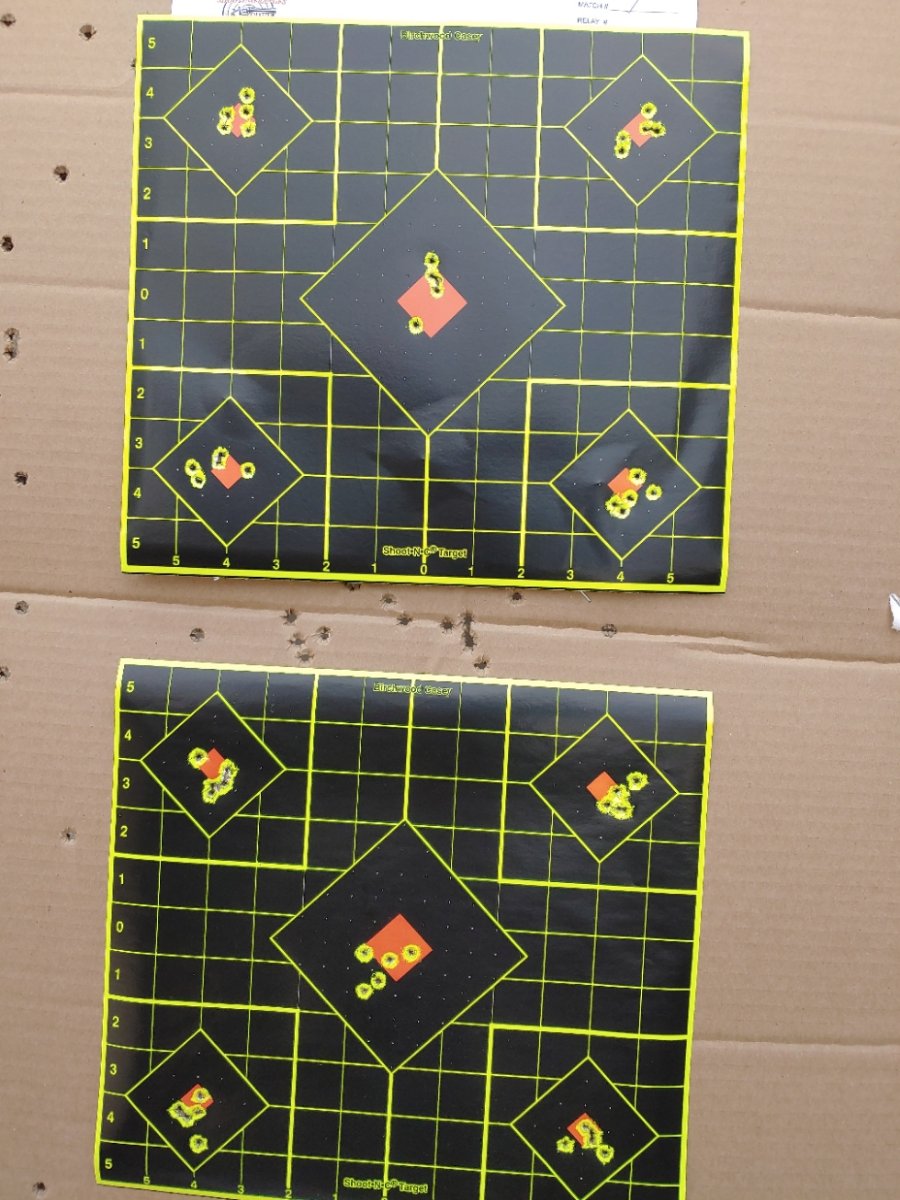

That Kidd bolt works flawlessly. Got a few shots in with SK LR Match at 50 yrs. Has the potential to be super accurate. I was a little Staley.
Re: CMP Rimfire Sporter match rifle
I'll say it has potental, that is mighty fine shooting!!
