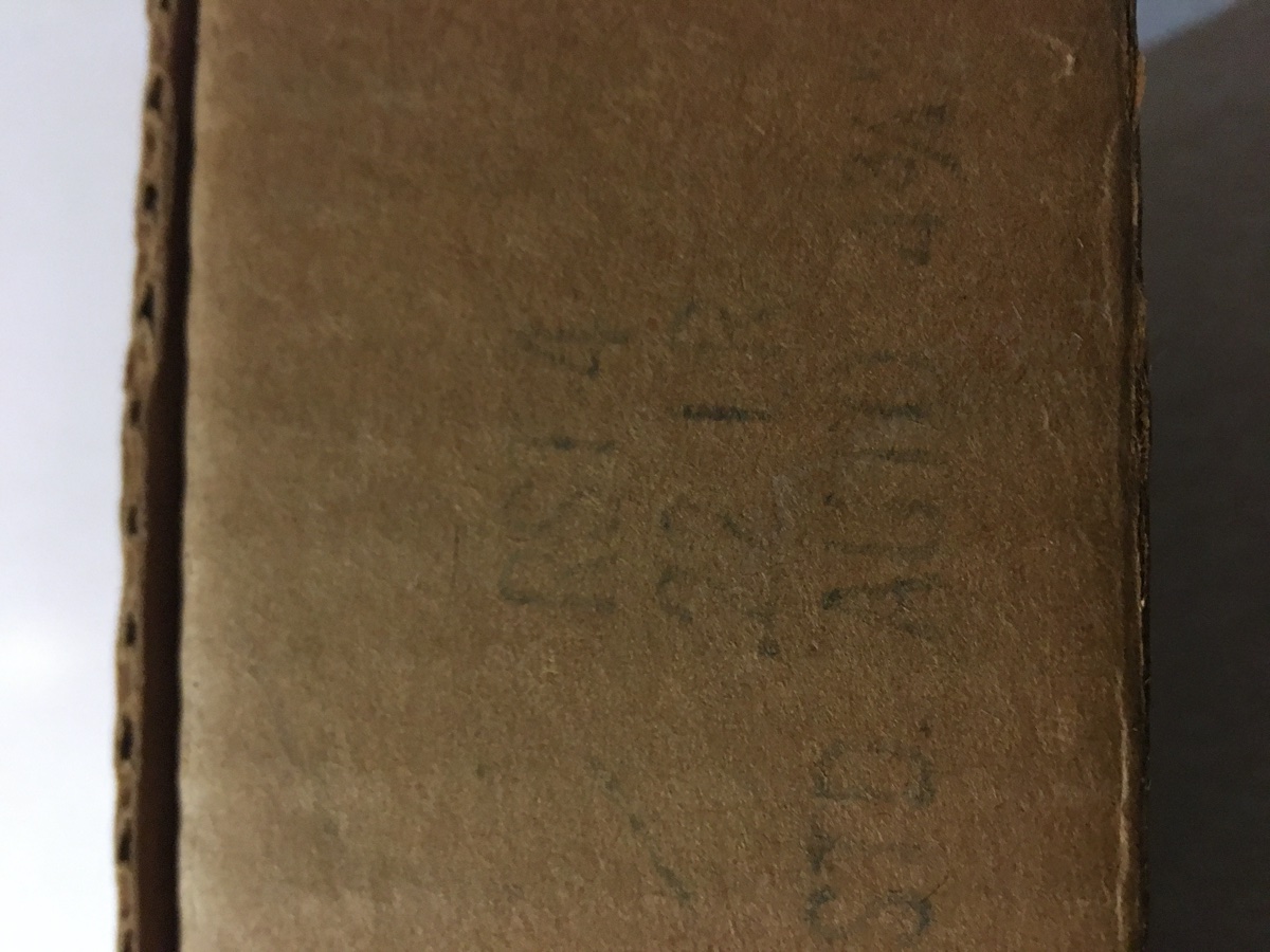

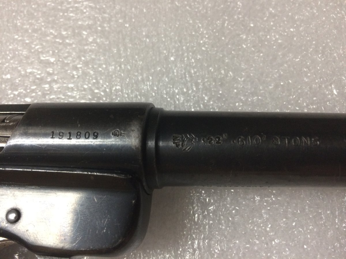

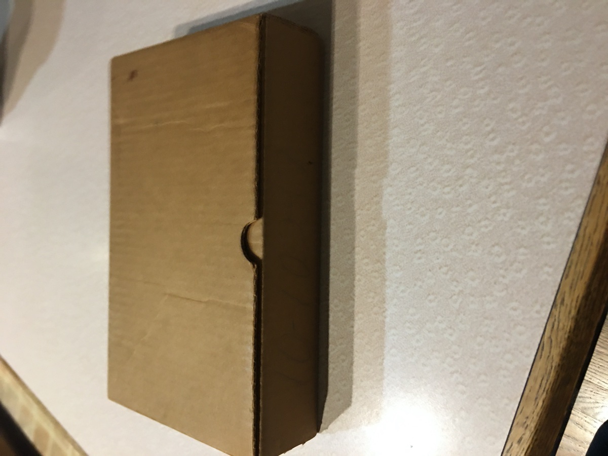

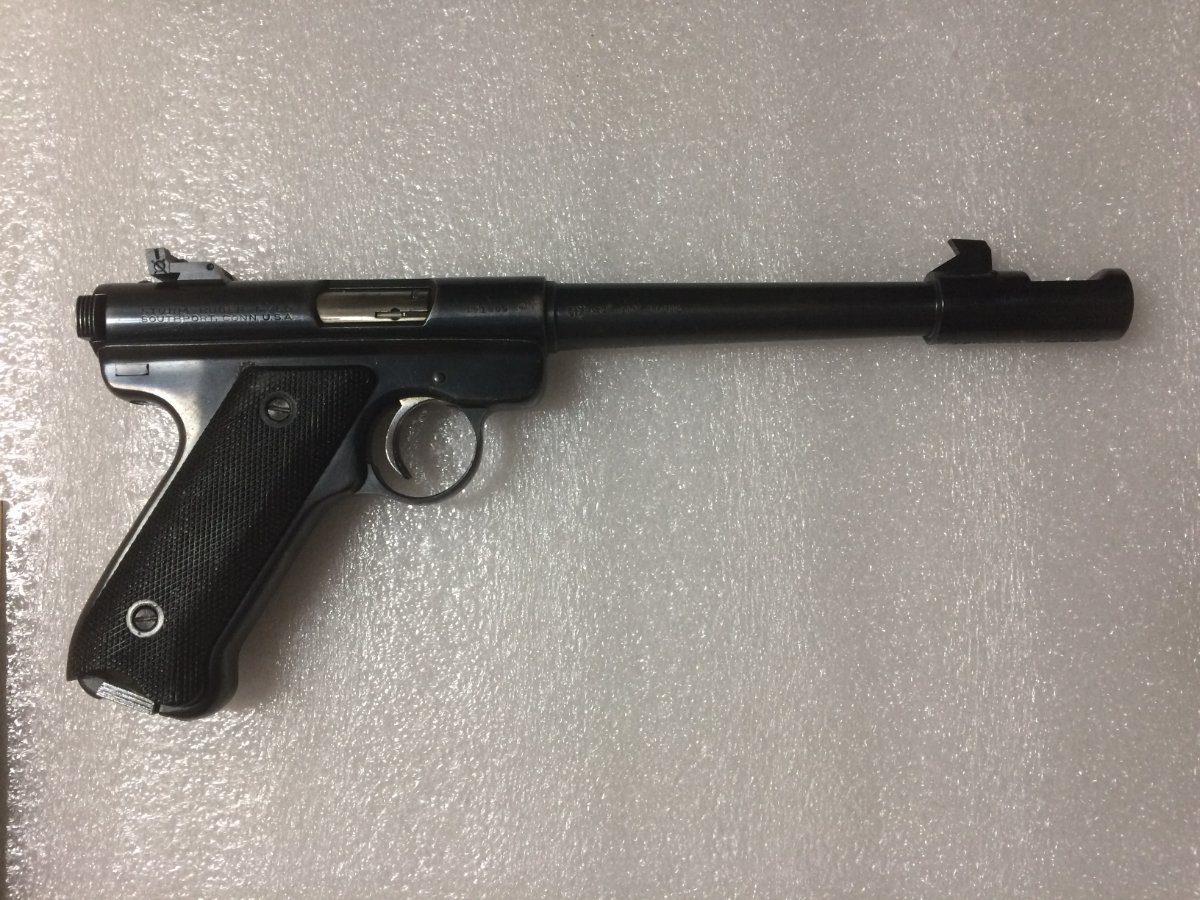

I just joined the ROCS and started looking at the forum in the last two days. Much to my surprise and delight there was a picture of my 22 pistol with the strange 10-10247 serial number. Earlier this month I sent a picture of the gun (which at the time I was thinking of buying) to Chad with some of the above questions. After that discussion and a $100 drop in price I bought it. Just picked it up on Tuesday. It goes well with my duplicate serial number guns.
The other neat discovery was that it is in near mint condition. May have been fired once but no scratches or blemishes at all. The Red two part box is almost perfect with bright color and no tears. I have read in Chad's book about the packing or shipping sleeve but had never seen one until now. Has serial number hand written on it and RST4, 22lr, 4 3/4 stamped on the sleeve.
