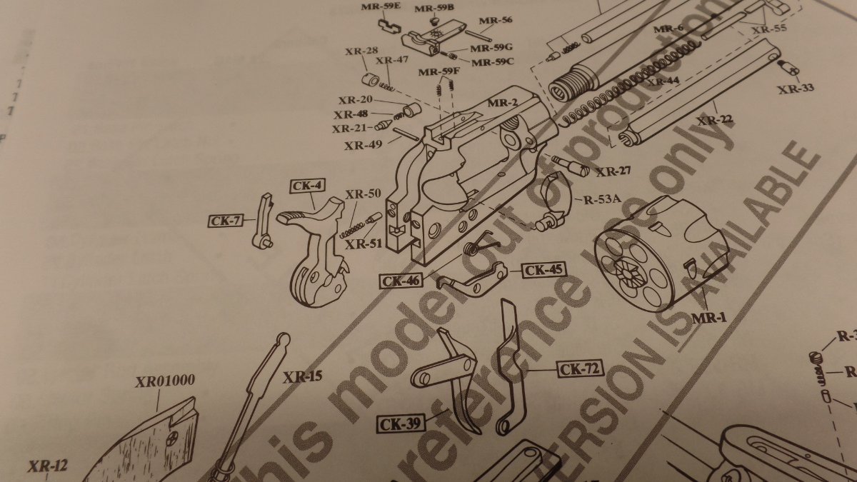

Re: I can't find the problem with my O.M. Single Six
Mike,
Here is a pic of a Ruger parts manual from 1995 & they do not show the parts available then, as they were trying to convert all the OM guns to the transfer bar system which of course came with a new hammer.
I would be surprised if some one has just the new parts you need, but then nothing much surprises me about the ROCS forum any more!!
Try what Ron said or PM Steve. I bet he has what you need, even if it's a complete hammer.
