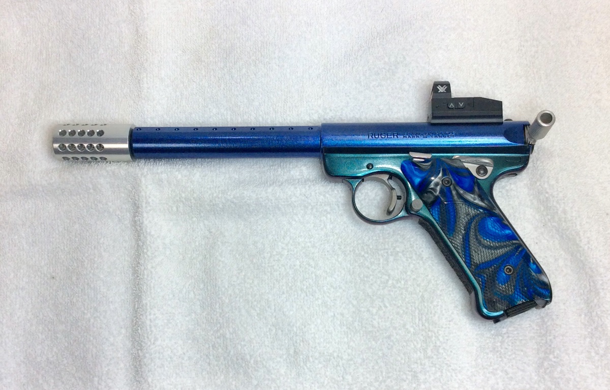

Well bill, here they are
It’s a MKII government target. And before anyone chastises me for butchering
A GT, the frame had already been modified and someone attempted to install
A rail on the receiver, so it’s collector value was gone when I got it and what a great
Platform to build from, right?
Yes, it’s a MKII, the mag release is a 1911 release! The barrel was milled and dimpled. Then
Threaded. All of the internals that can be replaced are volquartsen. As is the trigger, safety and bolt catch. The bolt is a MKIV that was dovetailed for a charging handle (my favorite part) and fitted with volquartsen extractor and firing pin. The mount for the vortex is a mad macs precision.
The comp is TacSol, And the last edition was the grips, custom done by lance schofield at LS grips. (He did the checkering in a pattern I requested, and had them to me in 3 days! Really nice guy too!
Posts: 1077
Re: What are they made of?
Rickkling,
Chastise you for making a super cool gun out of a ruined one?!?!?!???
NO WAY.
What a cool project 8-)
The best part of collecting is doing what you want.
Good for you. I love it.
Thanks for posting.
Posts: 1127
Rickkling I have to agree with JAYDAWG. It turned out great. I am glad you were able to get it made into something totally yours. Your machinist did a nice job. Did he say if the bolt was difficult to machine? I very carefully drilled and tapped the bolt on the RST4 I worked on for the guy with 1 hand. I don't know where that pistol is or I would post a picture to show you how it looks.
Posts: 2665
Really a cool looking pistol, thanks for letting us see it. Bet it shoots as good as it looks.
Posts: 1374
Rick, That is a really great looking pistol! Thanks for sharing.
