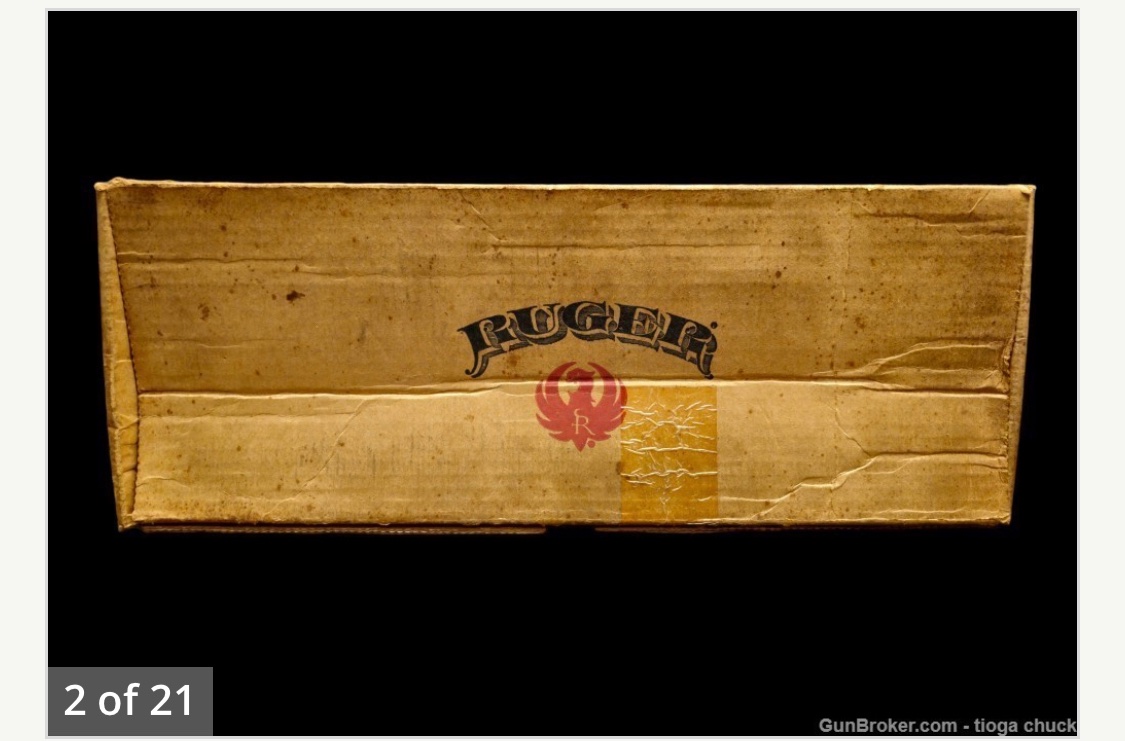

Ok, I found a picture for one of the brown boxes. Definitely not the ones you see for returned guns. This is from an active GB listing for a 1979 gun, SN 83-05xxx. Makes sense now.
So mine was made just after these and the yellow box will work.
Was fun to find this one.

Posts: 901
Re: NM SBH Box - 1980 S410N (I think)
When the New Model Single-Six came out in 1973 Ruger didn't have a traditional looking box for that, so shipped them in white hinged boxes with an end label that described the model. At somepoint, probably somewhere in the 65-prefix that box was changed to a plain brown hinged box.
So those are actually the same boxes used for the 10-1/2" Super Blackhawk when it was first introduced. Shortly after production began Ruger began printing them with the eagle logo and word Ruger.
I'm pretty sure though, the subject gun of this thread is late enough in the 83- prefix that it should have been shipped in the yellow hinged.

Thanks Chad! Once I reread your notes in the RENE deck I saw the serial number you noted where the brown boxes likely stopped. I'm sure I'll find a long enough yellow hinged box now. Articruger says his is 18" long. I've seen a few for sale, but so far all have dates on the back that are dated after this one.
Many thanks!
