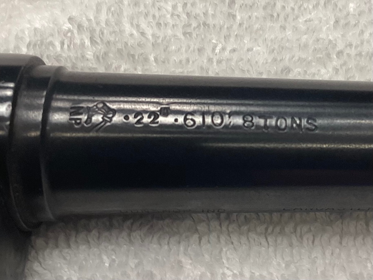

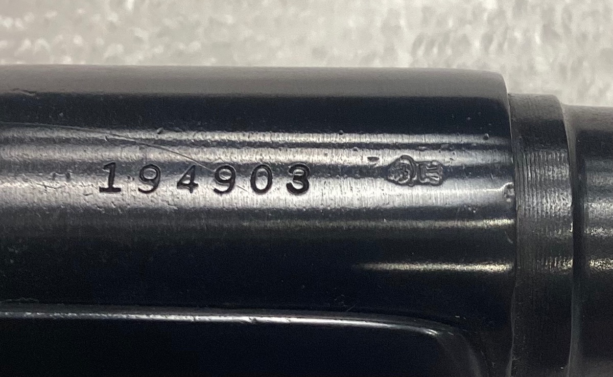

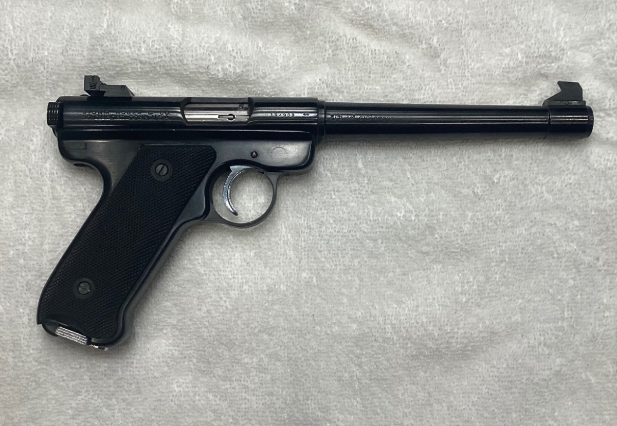

Ok gurus. I picked this up on GB today, and it seems like a good find.
It’s a MarkI that appears to be unfired, or it’s been properly refinished.

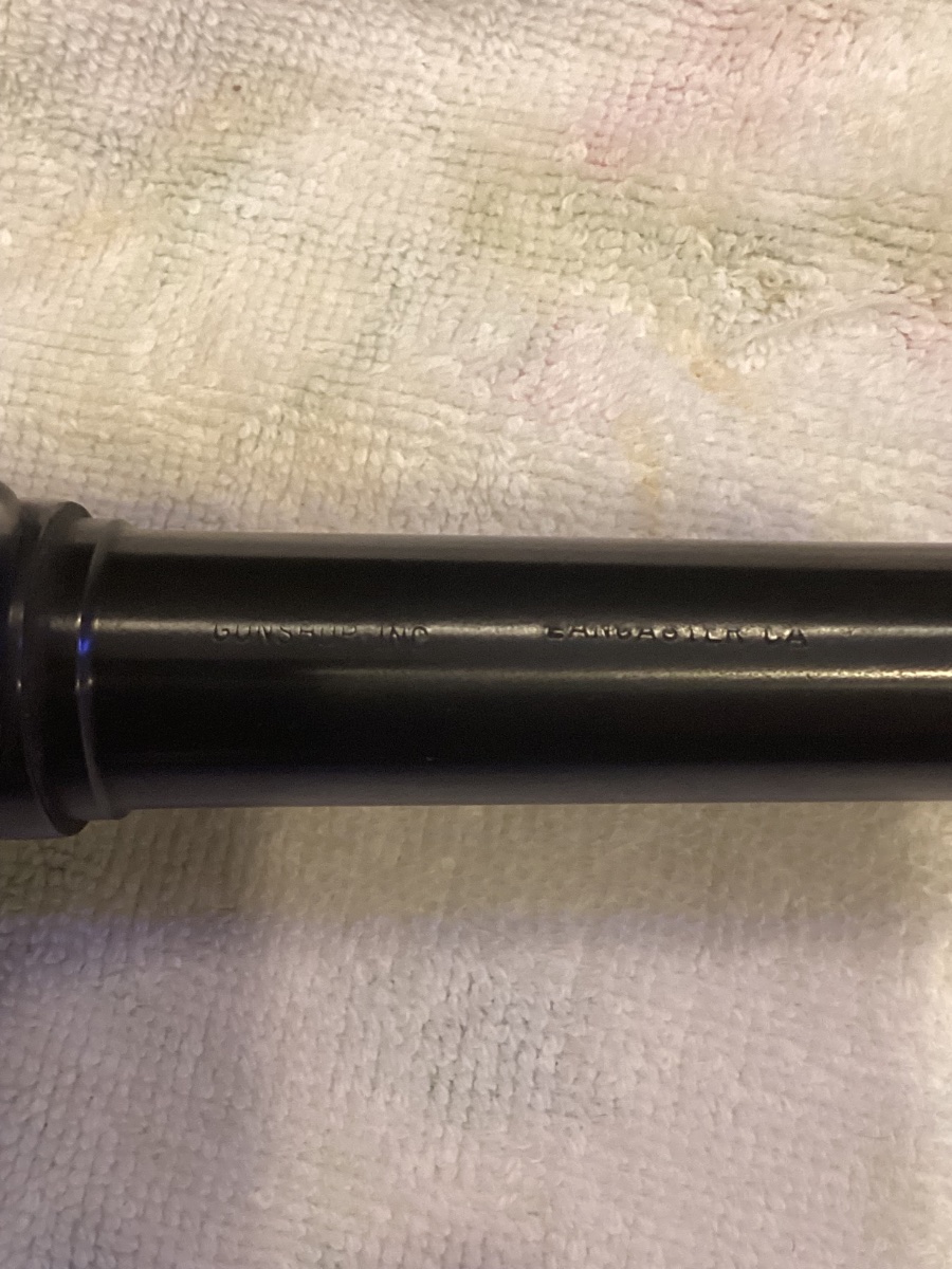

The interesting part is the British proof marks and what I believe to be the importers
Name on the underside of the barrel.
I’ve been able to decipher some of the proof marks, but not all.
If anyone knows anything about this gun or similar ones, I’m all ears.

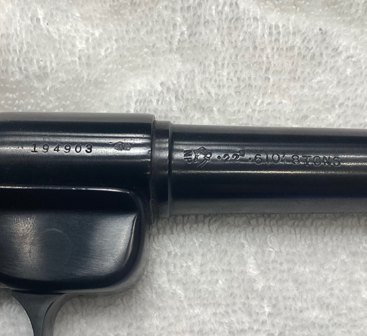

Hello Rickkling,
Here is what symbols indicate;
From left to right the markings on the side of the barrel indicate the following:
NP under sword = London Proof House, NP = Nitro Proof
.22" = .22 caliber in inches
.610 = .610” case length in inches
8 tons - proofed @ 16000 psi
The mark in front the serial no. = Definitive Proof Mark (@ chamber)
Under barrel are importer information as required by US Government on all imported products
I hope this helps, John

Yes it does John, thank you.
Someone on the ROCS Facebook page answered the tons and deciphered the importer name, but I wasn’t sure on the one by the SN.

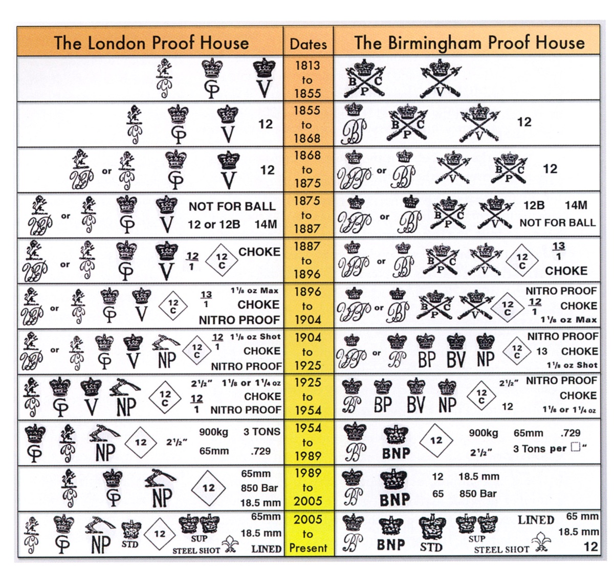

Hope these help.

This is great info, I have a British Proofed .44 Flattop so I will compare my proof marks with this document.

That is a great reference source for all firearms not just Rugers. Maybe that should be a "Sticky" somewhere on the forum.
Re: British proofed MarkI
Nice proof mark chart! The information that shows up here is endless.
