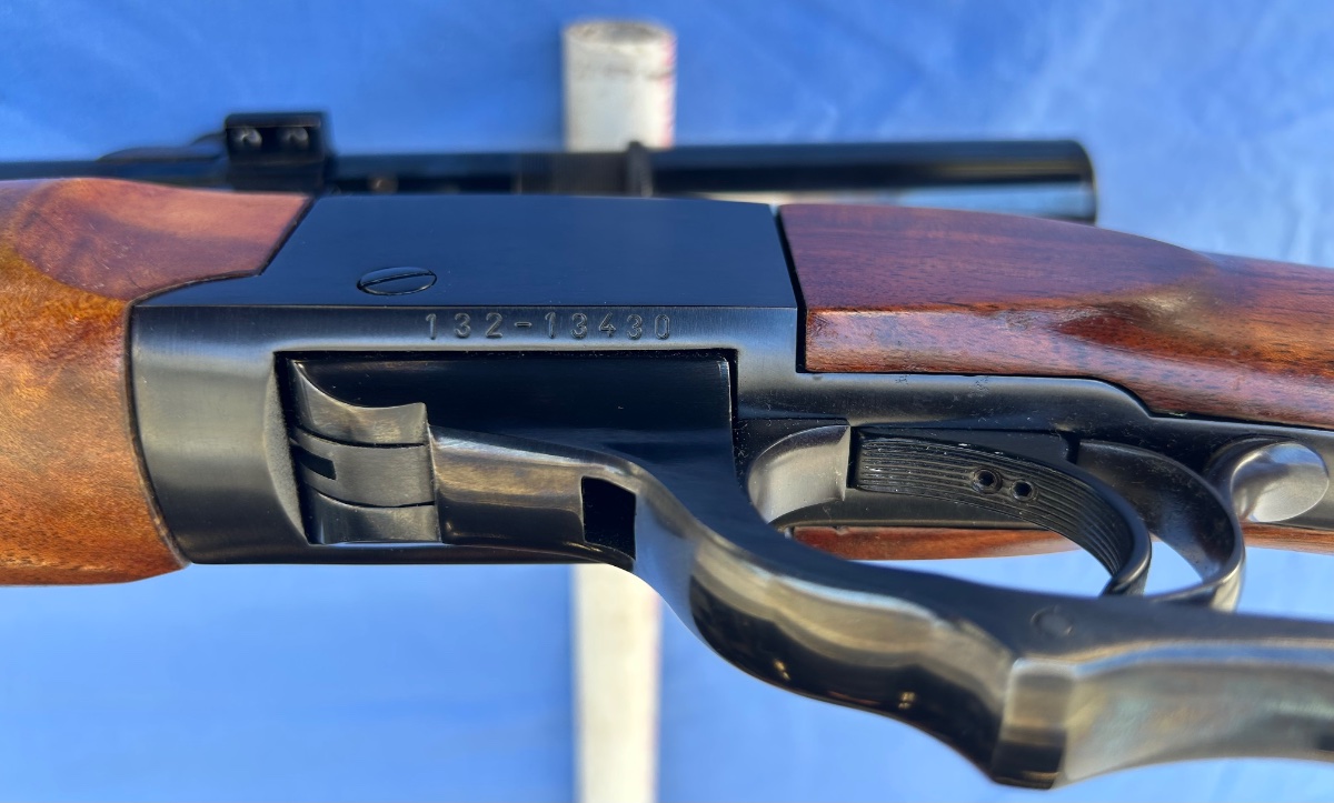

fishhuntnut
Posts: 191
Re: No. 1 tang length differences?
Post by fishhuntnut »
I just took a set of stocks that I had taken off an early #1 and put them on the 22 LR I had built. It is a 132 prefix receiver and the tang is longer. Here is a pic of the difference.. so I am assuming the earlier receivers were more erratic in tang length… hmmm
