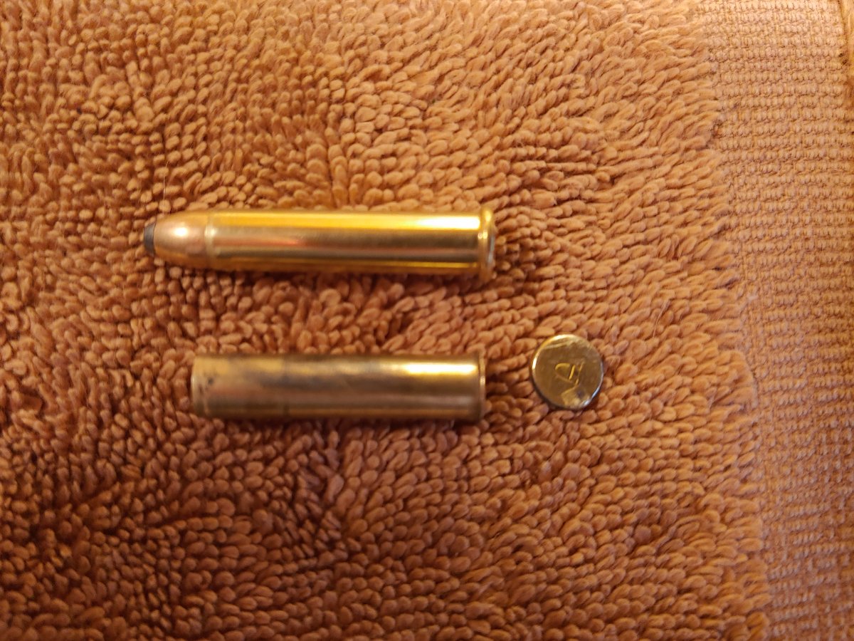

Finally made it to the range yesterday and it looks like I bought someone's headache. Started out shooting really well but then light strikes started happening - seemed like it happened only on the last round in the magazine but that must be coincidental. Accuracy at 50 yds was not bad but I didn't get check it at 100 yds because round no. 35 failed to eject and no.36 stove-piped and ignited in the receiver. The case head separated and I couldn't find the slug. No damage or injury but so glad for eye protection. So, the stories about ejection failures with the single-ejector bolts are true, I guess, and now I have to switch-out the firing pin and ejector. Any recommendations on parts? Never mind, I have found what I need here.
https://www.selectfirellc.com/22-MAGNUM ... s_c_9.html
Will that fix the problem?
Here are photos of the targets (top one is sighting in and the bottom is 3 groups of 5) and the case and ammo. Shootus interuptus didn't help accuracy. The 40 gr bullets should be fine

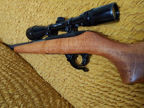

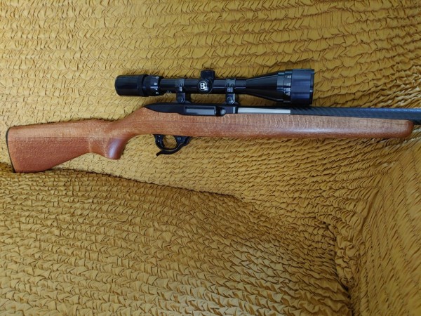

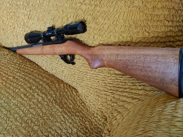

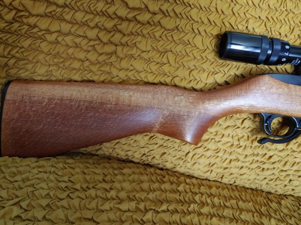

Got around to the refinish - man, that factory stain was laid-on heavy and it was hard to remove. Birch doesn't take stain like walnut so it has a light application of Minwax Gunstock 231 with a hand-rubbed linseed oil finish. Nothing like the look and feel (and smell) of oiled wood imho. The grain is exposed and some nice light-play is revealed. This slender stock is a pleasure to hold and the combo is a fun shooter, now. Some pics:
