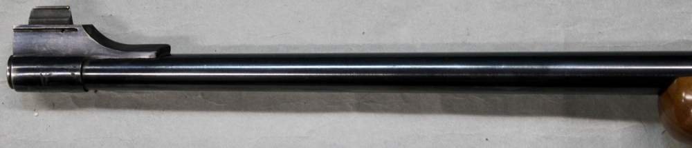

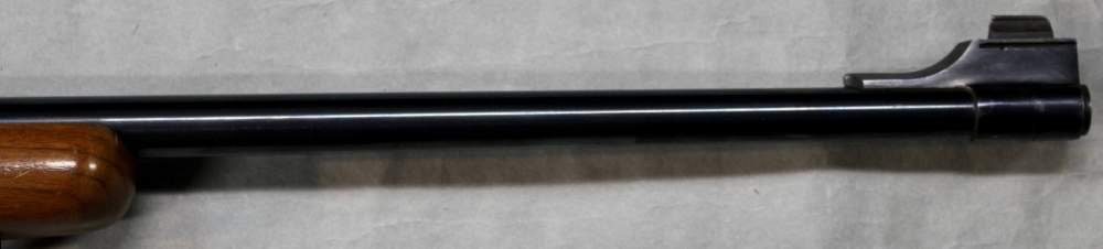

I've been looking at the front sights of likely M77 rifles ever since I learned about the existence of a very few that were slotted for a hood. Well, I finally found one in a Gunbroker auction that closed on Christmas Day. I think Santa Claus was involved.

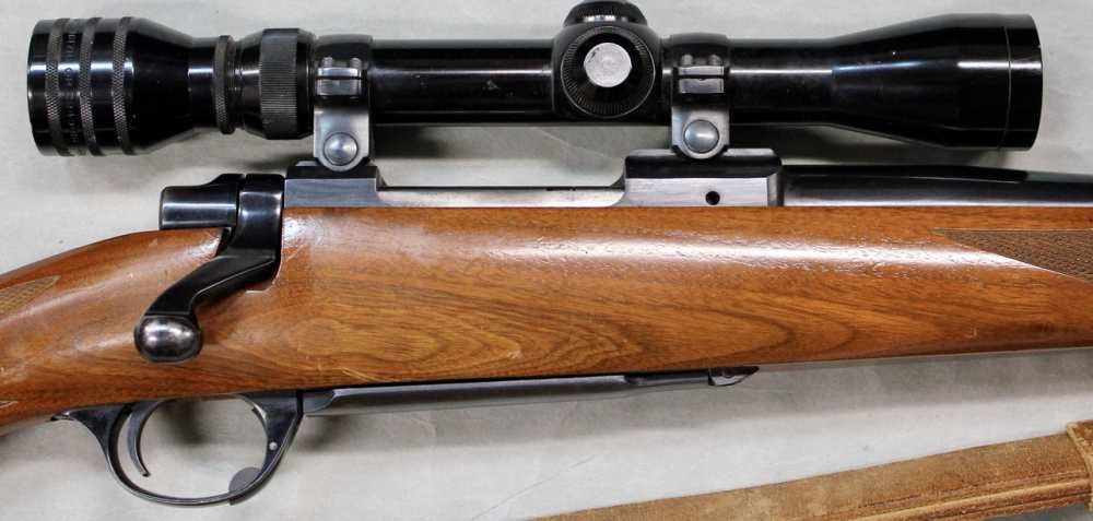

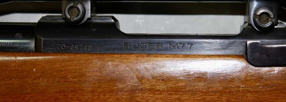

Anyhow, SN 70-09740, a well-used, flatbolt RS in .243 with a slotted front sight, is on its way (figuratively) to my house. It also has an aftermarket trigger with no safety, which concerns me and I'm hoping can be restored. Anybody ever seen a slotted sight rifle before or have any idea of value? Some pics:

Your rifle also has the early style contour, straight, below the ejection area.
There are a few around with slotted front sight bases. It seems there are a few known right about the same time your serial number was produced.

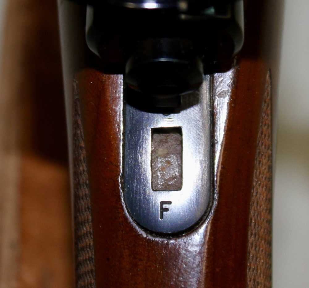

Finally brought it home and looked inside. Looks like a stock trigger but this is my first time working on a 77. I'm hoping someone can tell me what it is and what I need to restore the safety. The stock has been bedded and JUN 14 1968 is stamped in the channel. Pics:
Posts: 921
Re: A very rare M77
Looks like all you need is the Safety Link and Safety Button. As far as I know these two items stayed the same through the Tang-Safety generation. The attached pic is from a 1971 flatbolt.

I found a YouTube video and, yes, the wire slips under the arm.
The stock had been bedded, which caused the tang to sit lower in the stock, making the safety button contact the wood. I had to remove some material to allow it to operate.
