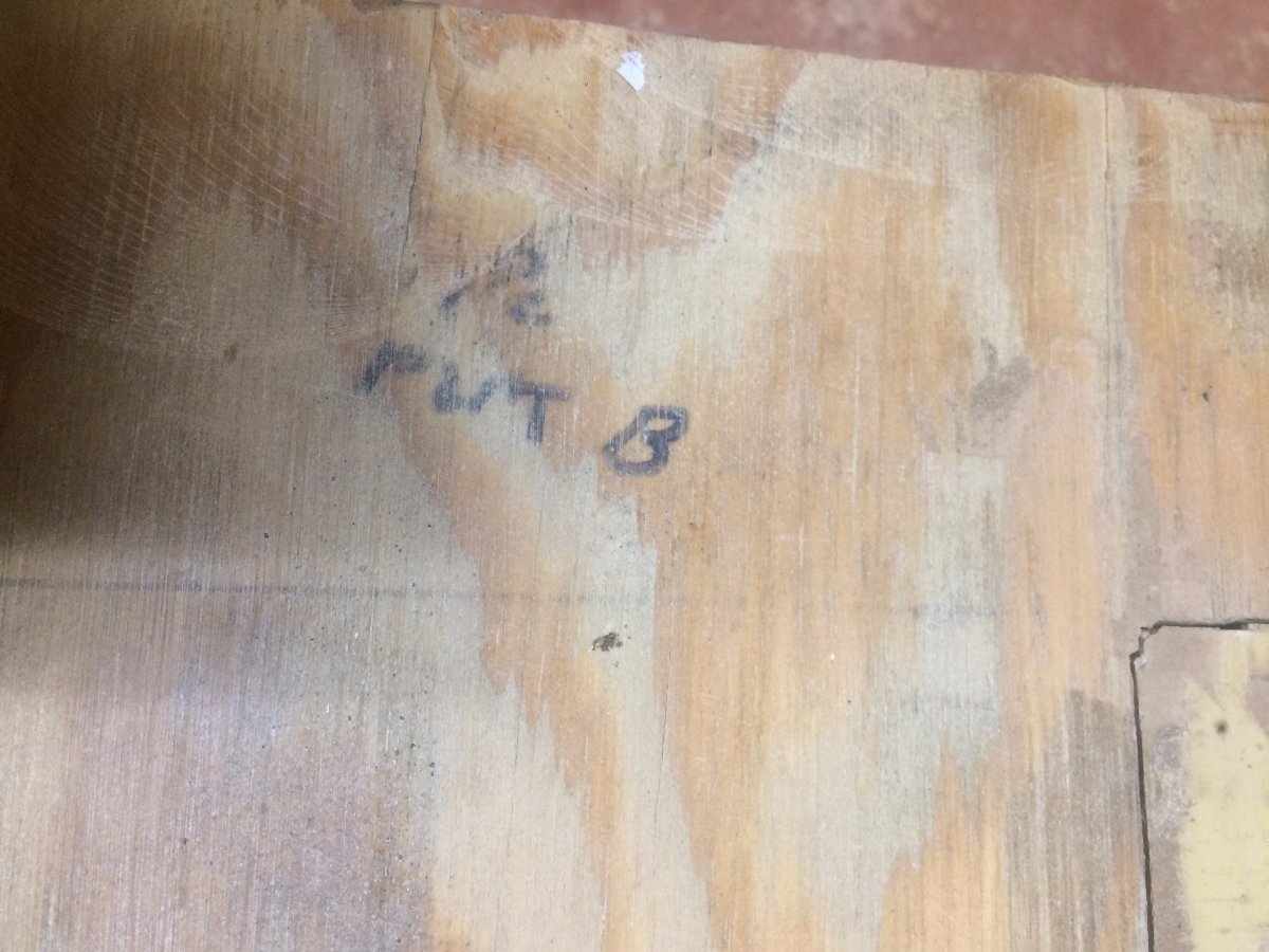

So this is also something which I found extremely interesting. It came from Pine Tree Castings, is well built and heavier than it looks. What I have determined is that is a mold ultimately used to make a large Ruger bird. I have determined that chalk was used to line the entire inside of the mold on both pieces. Then, a maroon colored wax was poured into the inside of either part A or B. Parts A and B are labeled on the back of each. A has the eagle and B is a flat square. Once wax was poured the mold was bolted together on each side until dry. The small trays on the side of each mold would have caught the excess wax as you pressed the mold together. Then, what comes out is a large square of wax with the eagle pressed into it but when you look at it, it would be a reverse.
This is where I need someone more familiar with their operations to help me fill in the details. From what I understand they take these wax molds and coat them in something which allows them to bake it. The outcome of that would be another mold that molten metal would be poured into. Once this hardens you would have a large correct metal Ruger emblem. I'm interested in anything that anyone can tell me about it. What a former employee of theirs told me was that he thought it was a metal mold itself but there is no way this wooden thing could take molten metal. I find evidence of chalk and wax only. Anyway, enjoy.

this is used in what is called a "lost wax casting process" ...you can Google it for detailed information on the process...

One of the things I have worked at and had training in was foundry work. They would make a wax copy in the mold you have then cover the wax image with a plaster casing to pour the metal in. This plaster casing would either be centrifuged or vaccuum suctioned or both to remove all the wax as the metal was forced into the mold. With the lost wax process there can be greater detail with less machining to finish the piece. Lost wax is also used for dental bridgework or to make tiny intricate pieces. The Single Six was one of the 1st lost wax investment castings done by Ruger & the Six Series DA revolvers had a stronger frame than the competition because of the casting process. You have a great item there
