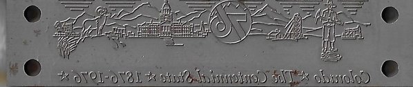

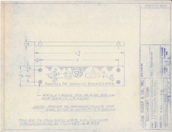

Original blueprint with the actual die for the Colorado Centennial cylinder. Shows details from Colorado "history & lore" as the cylinder was rolled over this die. This is called a flat die.

Interesting stuff. I wonder how much pressure has to be put on the cylinder in order for it to show up?

Just talked to a buddy that runs a die shop and he said about 7 tons of pressure to roller engrave a cylinder. For cylinders they would use a flat die as shown while barrels and recievers are marked with a roller die. I love precision machinery! I will put pinpoint tips on a set of vernier calipers soon to see how deep the engraving is on my New Model Stainless Bearcat cylinder. Will be interesting to find out
