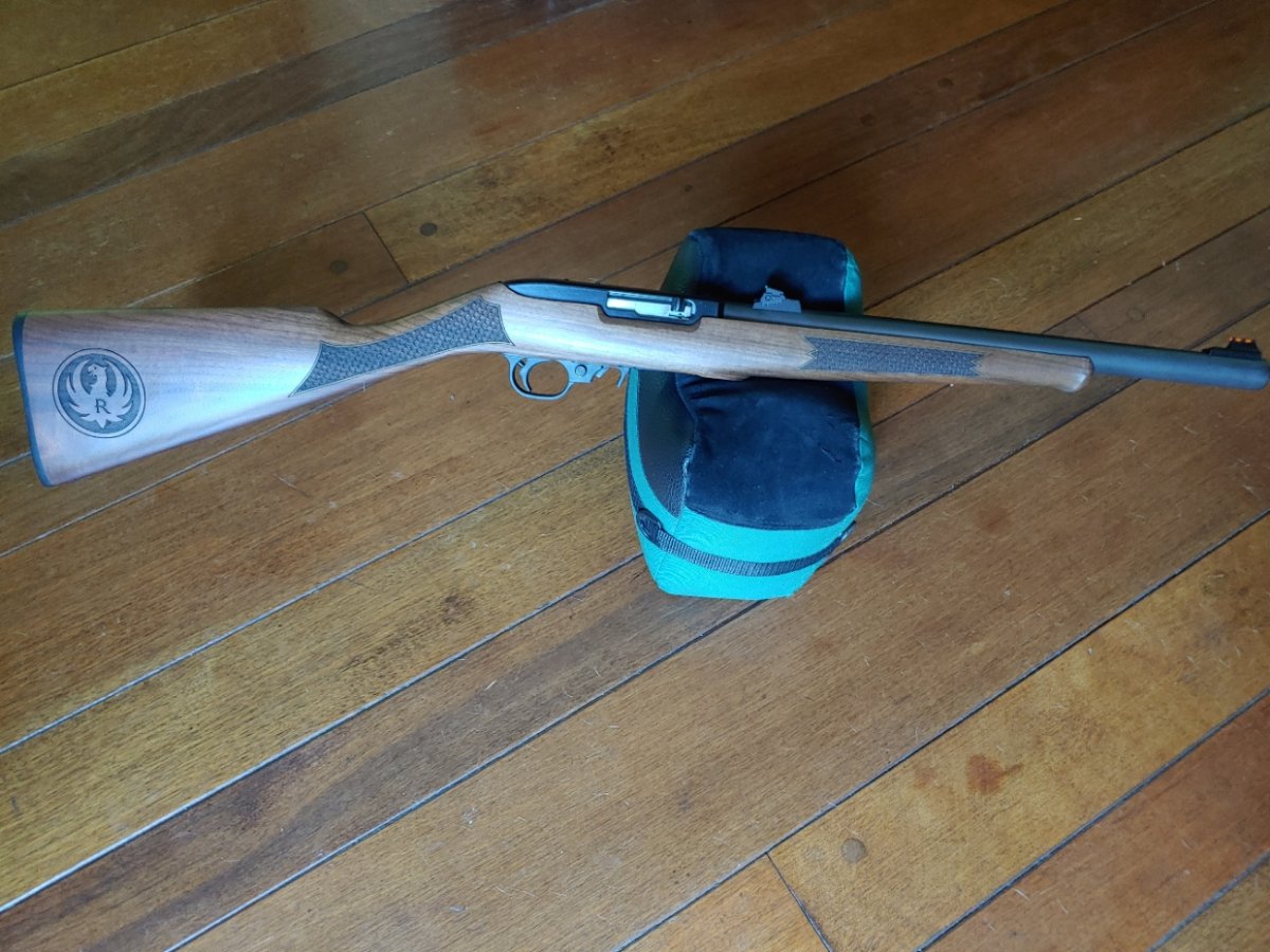

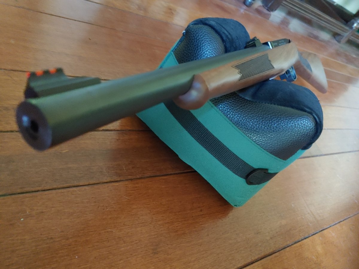

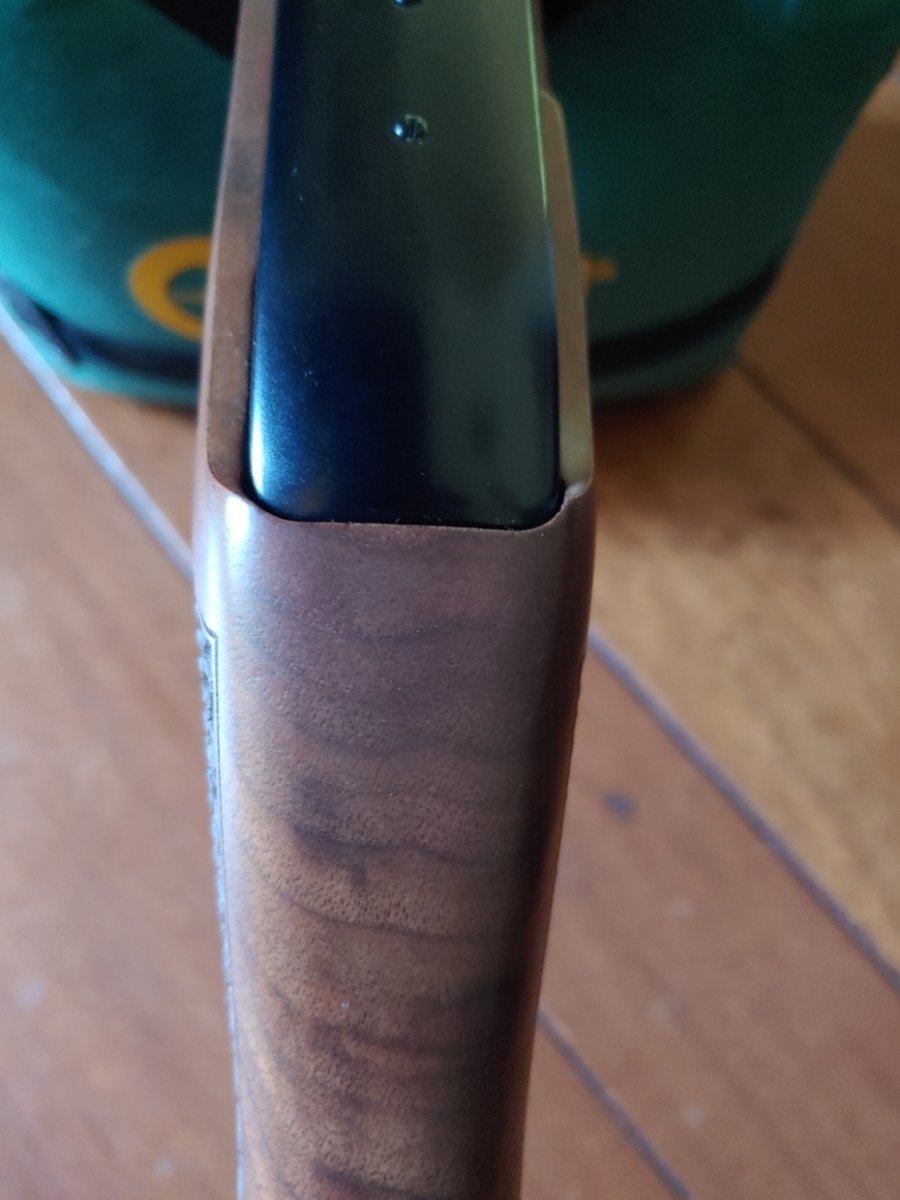

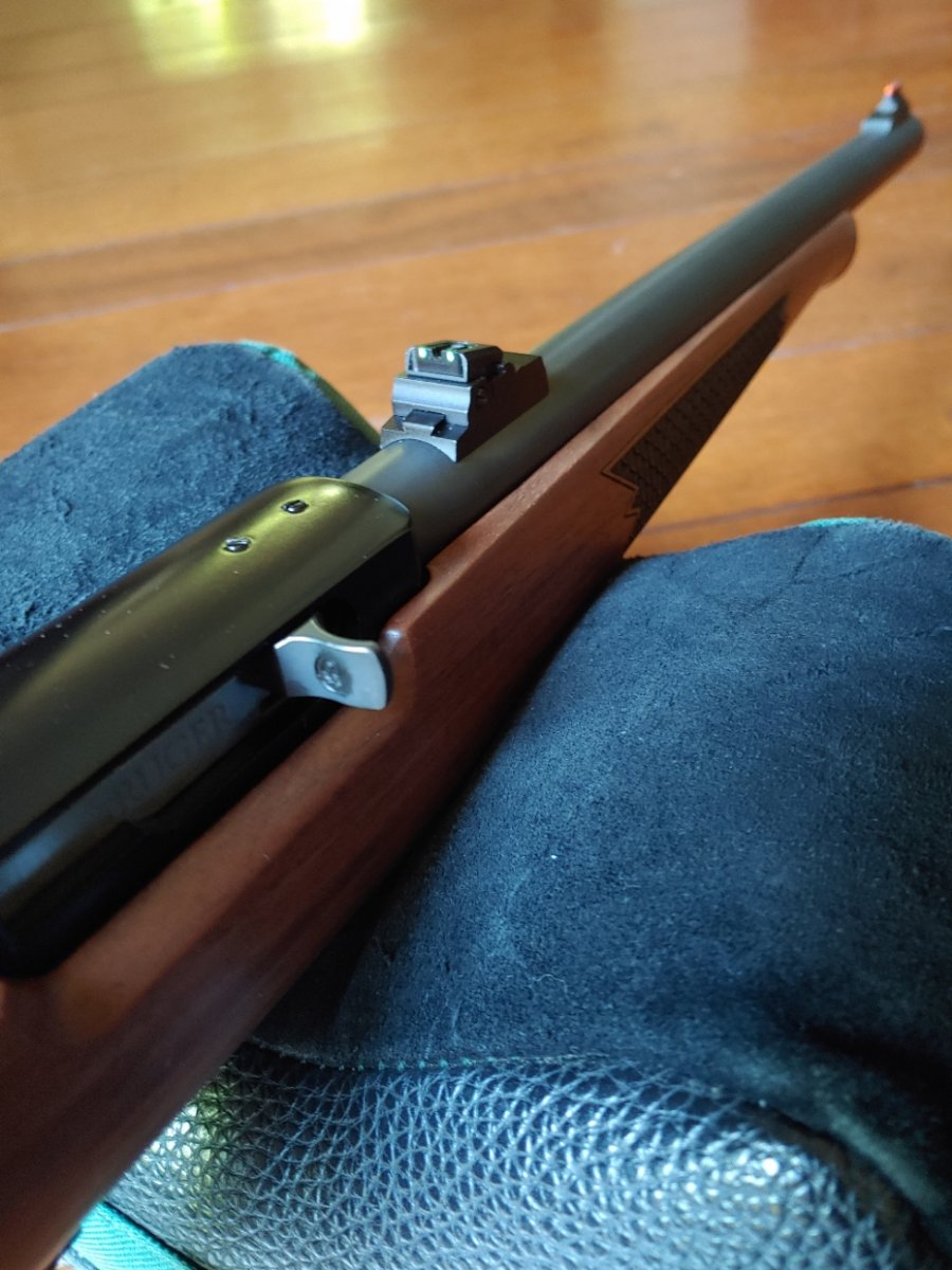

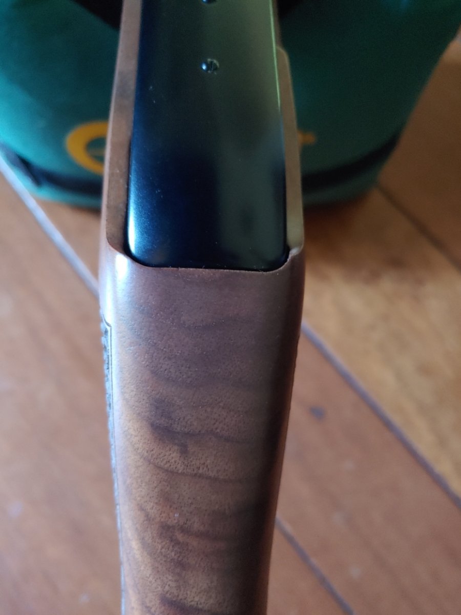

More photos. The stock sits a bit proud at the rear of the receiver but not horrible.

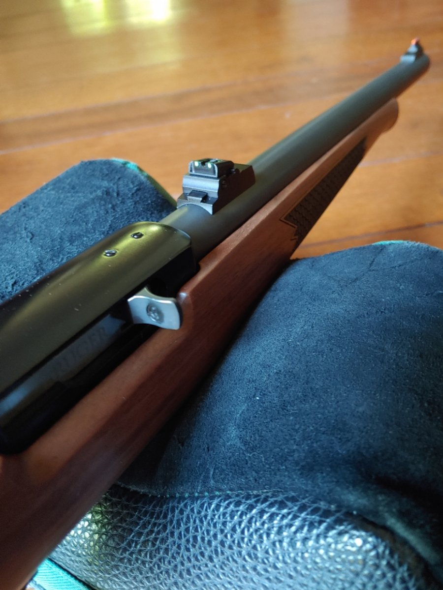

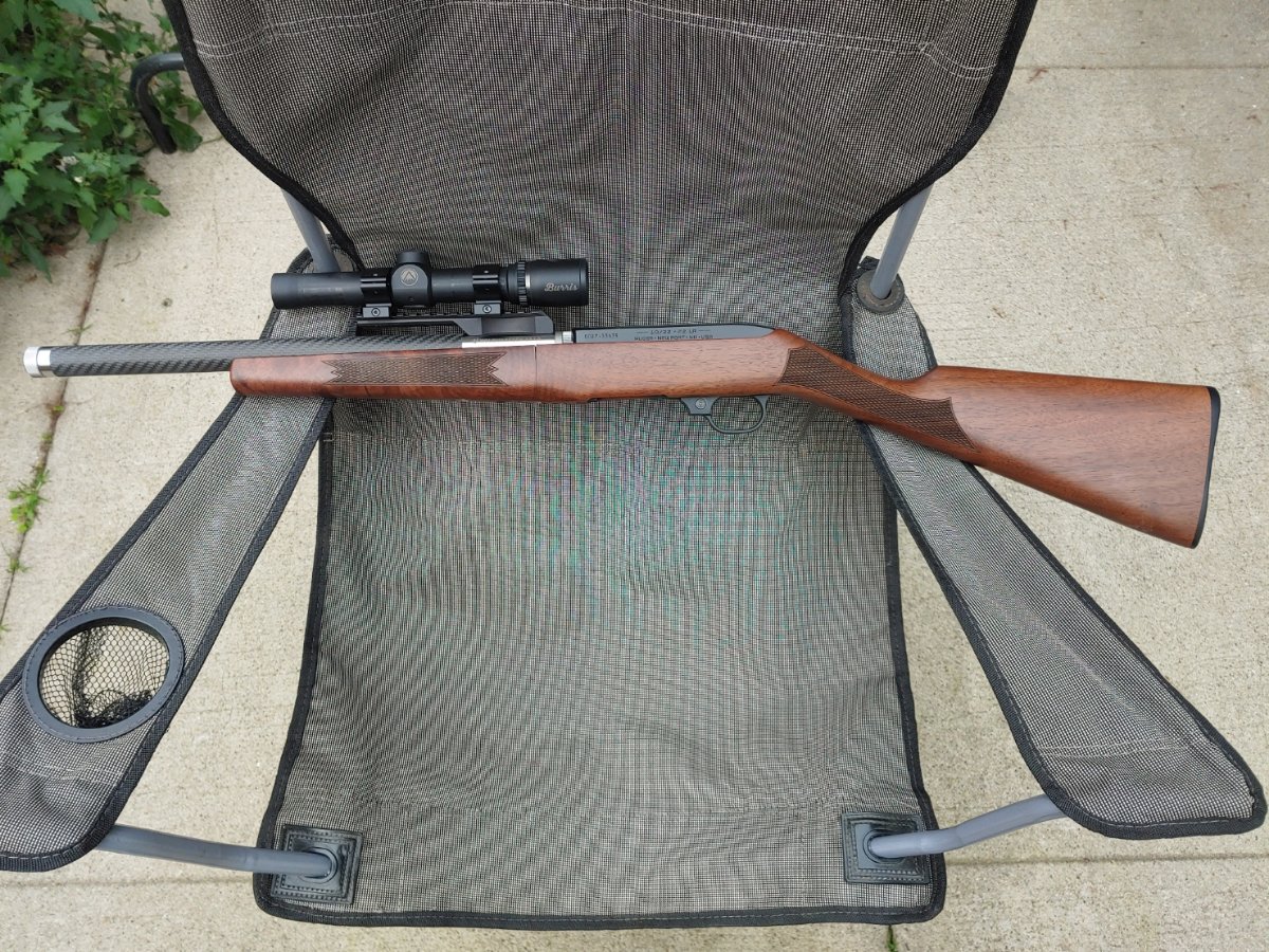

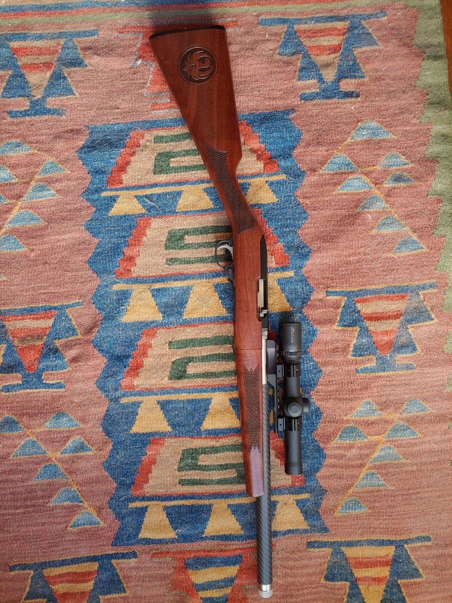

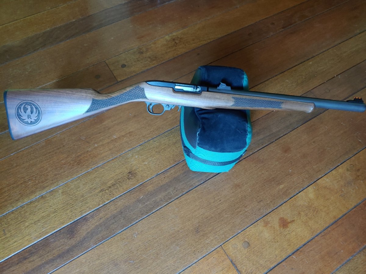

So, I took that extra stock set, opened the forearm up for a bull barrel and made a modern interpretation of The Chief's Scout Carbine as a lightweight, takedown scout. This is absoluutely, positively my last 10 22 money-pit custom build. The barrel is Volquartsen with the rail turned around to get enough eye relief for the Burris 2.75x20mm Scout scope, which I also had on-hand. I only have a mock-up to show because I've misplaced the trigger pin and nobody will sell into California now because of this stupid new gun part and accessory law. Can someone please take pity on me and slip me a trigger pin? Happy to send cash back. Better pictures coming when it's done.

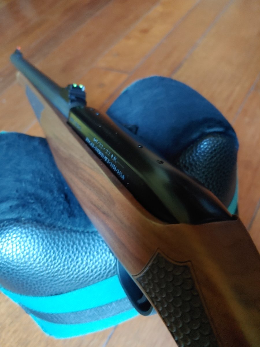

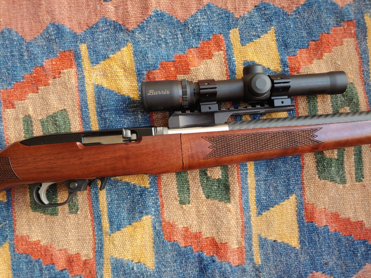

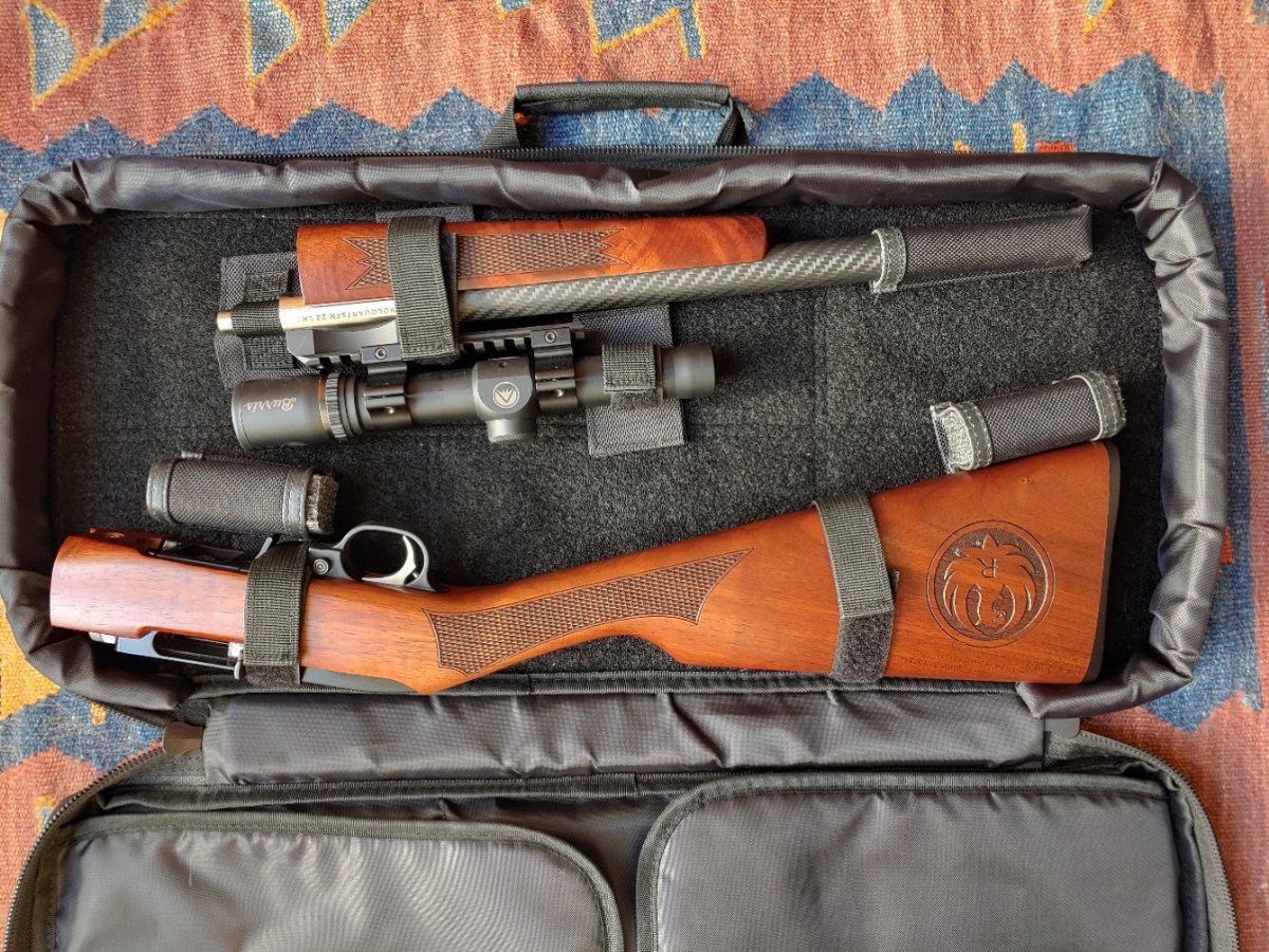

Many thanks to LDB for assistance with the pin.
More photos:

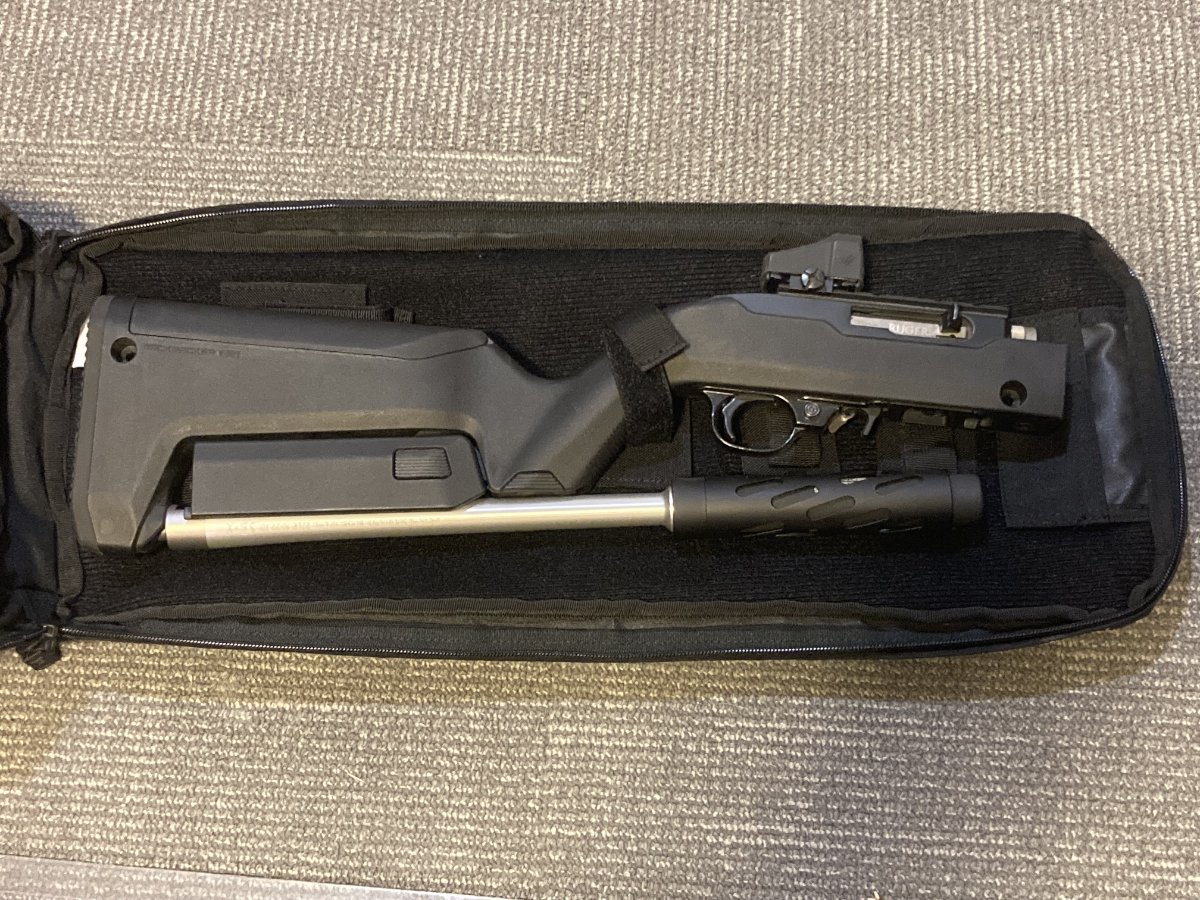

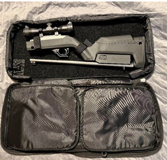

I keep thinking, then convincing myself otherwise, that I should snatch up one of those wood furniture takedowns.... You're making it a lot hard to convince myself I don't need one....
My current takedown, with the backpacker stock, is a fantastic little rifle, but without the wood, it just has no soul....

Went to the range today with the Scout. The trigger still needs some work but it will group inside an inch at 25 yards using SK long range match ammo. I wonder if re-facing the stock bolt would improve things?
