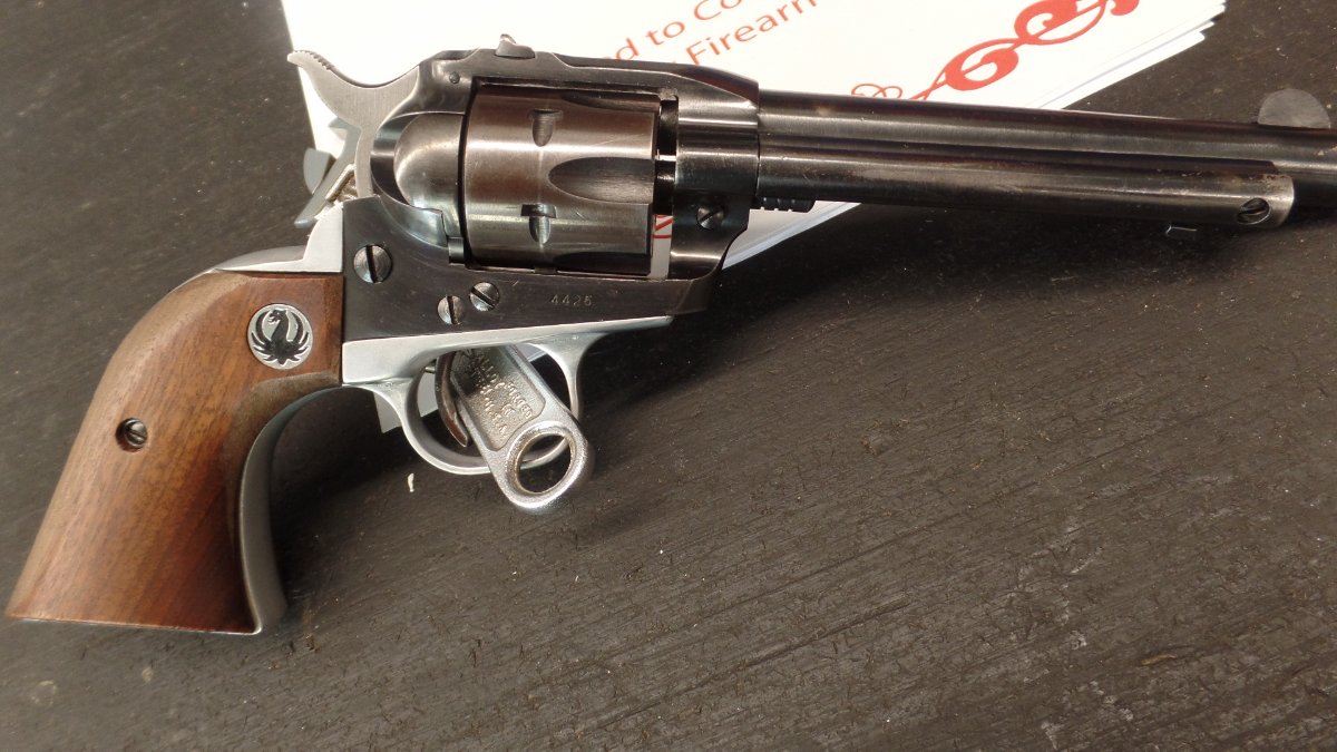

I picked up a 4 digit Single-Six, kind of a beater, but I can't pass these up :shock: :)
Correct sights & ejector rod length. Not converted. Polished grip frame and wrong grips.
Round loading gate!?!?
I have read somewhere that some folks didn't like the flat gate and replaced it with a newer
round one. Or with the other issues is this a Frankenstein gun, parts from more than one gun??
OR....should I get a Ruger letter and see when this one was shipped, maybe a parts bin gun
released at a later date?
All thoughts and comments welcome.
Enlighten me team ROCS......

By the looks of the picture it looks like a 'Premier' loading gate to me. They were a supplier that sold loading gates, grips, front and rear sights for Rugers. If you have another Single-Six from serial # 63,000 up you can compare then and see that the Premier gate are a little longer measuring from the cylinder to the end of the loading gate. I have a few of them I guns I have purchased years back. J/S
The previous owner some where down the line brushed of the grip frame to the shiny aluminum finish. It should have hard rubber black grips also the wood grip were not produced until 1957 approximately.
Great 22 shoot it and enjoy one of the finest well built single action revolvers made.

Neat gun. I think the loading gate is a standard Ruger. Here is a picture of the Premier gate and you can see it takes up most of the opening on the frame. You got a neat gun either way.

Good info above and to me it is typical of many from back then, the grips frame removed, polished out, grips replaced and the loading gate replaced, YES, it could have been replaced by the factory ( the loading gate) BUT a 'letter' will NOT tell you that information. I would remove the grip frame look/see' if it was stamped with the "R" meaning it went back and was safety updated, could have had parts changed then and the owner removed, swapped back, the 'lockwork', if only it could talk and tell you, the factory letter will NOT. 8-) :roll: ;)
Nice gun, and would be a great shooter, use it........ :)

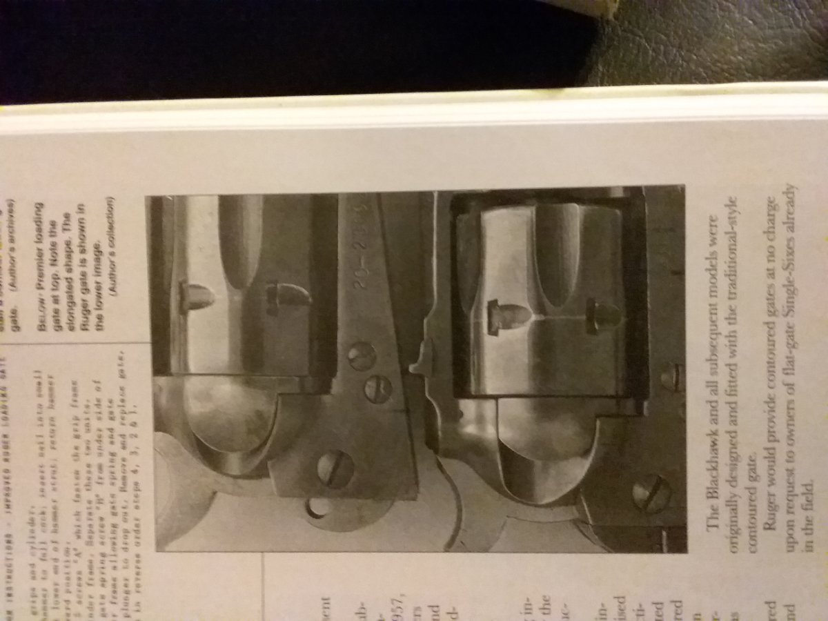

Jay, my best guess is that it is a custom job done by previous owners but it's still a neat one to have and get out and enjoy. Here's a picture of the loading gates from John Dougan's book, sorry about the orientation, if you double click the pic it will be turned right.
Posts: 948
Re: 4 digit Single-Six Question
Bennett,
Thanks for the pic, mine is for sure Ruger, the shorter one.

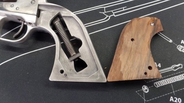

Here is another picture with the grips off. I was unaware that
the grip locator nub on each side of the grip frame was a pin, since
this one has been removed.
Another hole was drilled in the grip frame and a roll pin put in to
hold the newer style grips.
I'm going to pull that roll pin out and put another back in the original
hole so I can put some grips on that fit correctly.
