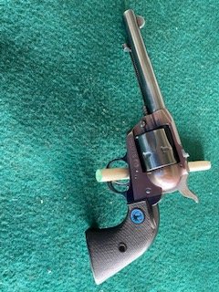

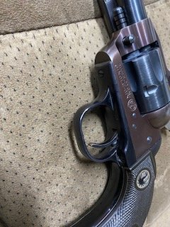

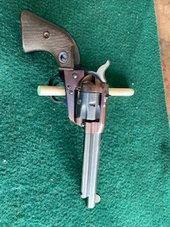

This colorful gun was offered at a decent price and I just had to buy it to compliment my early Six collection. These are seller's photos. Enjoy.
Posts: 2665
Re: Plum frame RSS5
That's PLUM purdy!! I love those early RSSs and BKH3s that have the pluming reddish frames. You did good!

Thanks for the comments. What a looker - I knew you'd like it. I won't be able to bring this little beauty home for a couple of weeks. Looking forward to cleaning it up a bit and taking some photos that do it justice.
It is quite nice the way it is but a set of Stags would put right over the top.
Does anyone know how this might have happened at that point in production? Since it came out of upstate NY, I wonder if it might be an employee assembled gun?
