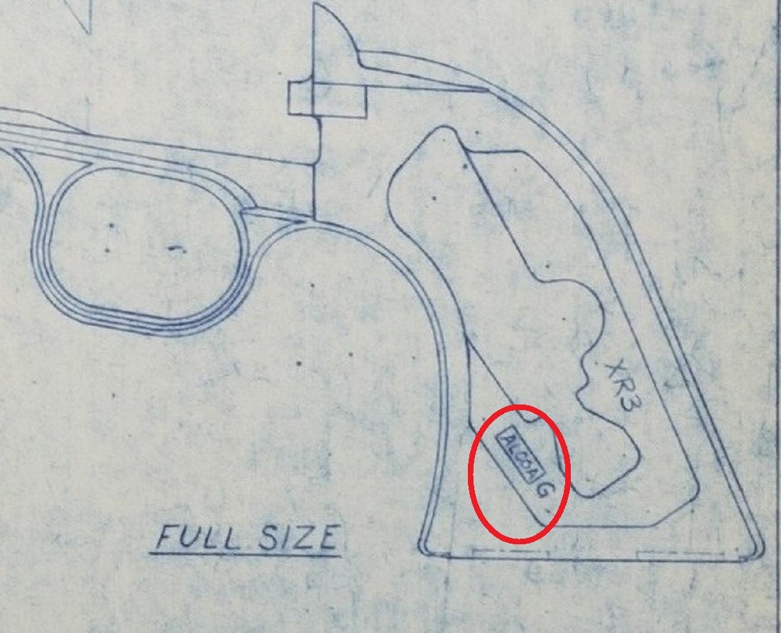

1952 Blueprint
1952 Blueprint

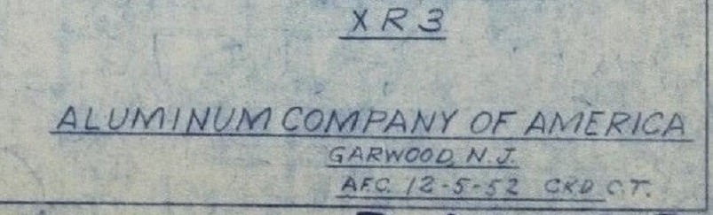

Drawing submitted to SR & Co from the Aluminum Company of America (ALCOA). XR3 grip frame for the new Ruger Single Six revolver, 1952. The letter G shown in second photo signifies Garwood, N.J.

- The letter G is for Garwood, N.J.
- 2.jpg (102.63 KiB) Viewed 4908 times
- 1 - Copy.jpg (210.06 KiB) Viewed 4908 times
- 1.jpg (297.46 KiB) Viewed 4908 times

Re: 1952 Blueprint
Thanks Don. Now I know what the "G" stands for on the early frames! This is great stuff. Do you have any documents concerning the production of the factory brass grip frames or the introduction of them fitted to guns? Brass Frame/Lee
