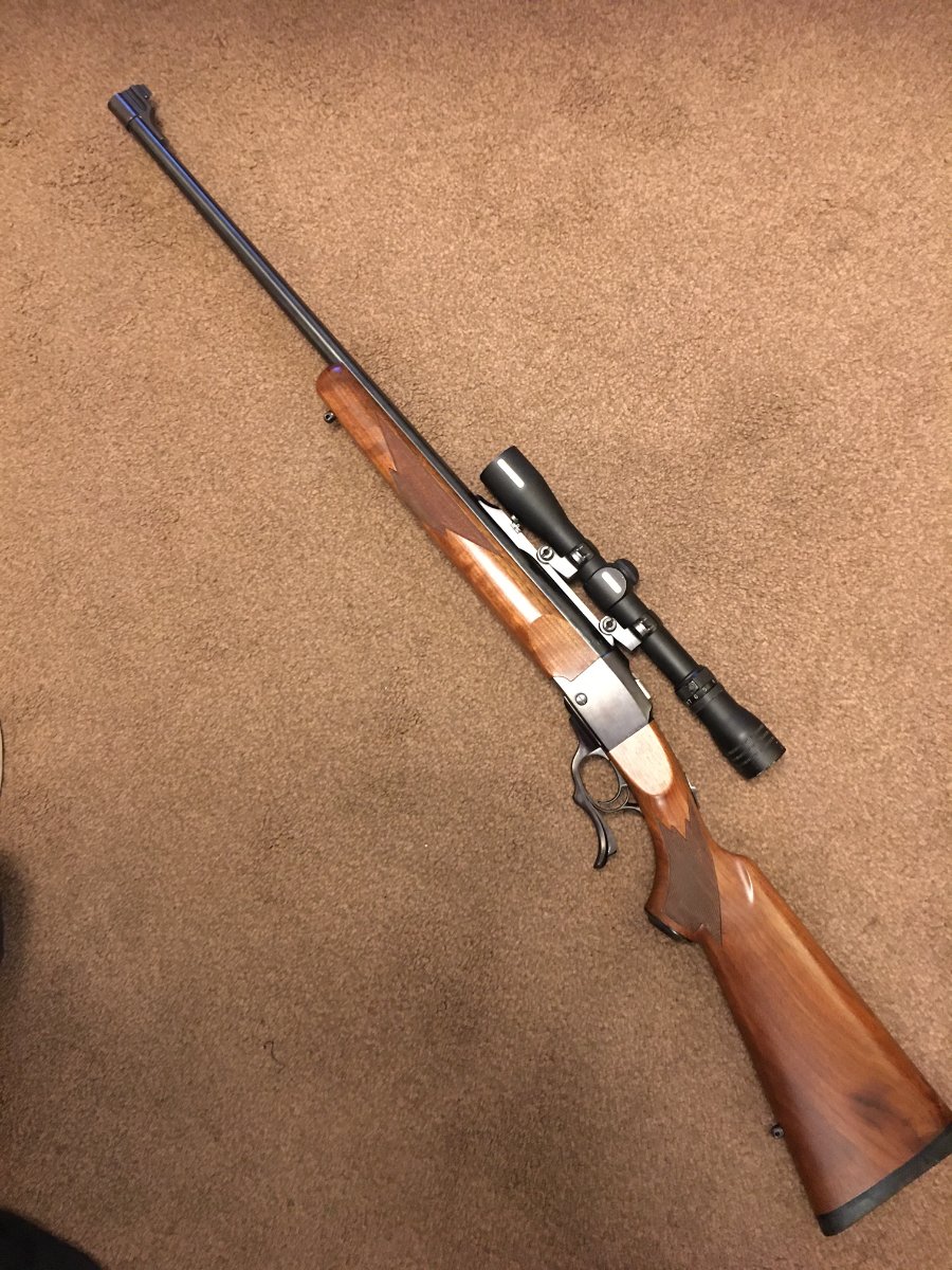

Hi Chet, It has a 26" medium barrel but it also has sights, I'm not sure what qualifies as a beavertail foreend .
I've tried to attach a picture of it.
Since that pic I've swapped out the scope and put my old Zeiss 1.5 x 6 on it as it really is a much clearer scope than the Redfield Widefield it had on previously.

That's a beavertail there, but with sights, that is very unusual- as in dang unusual!
