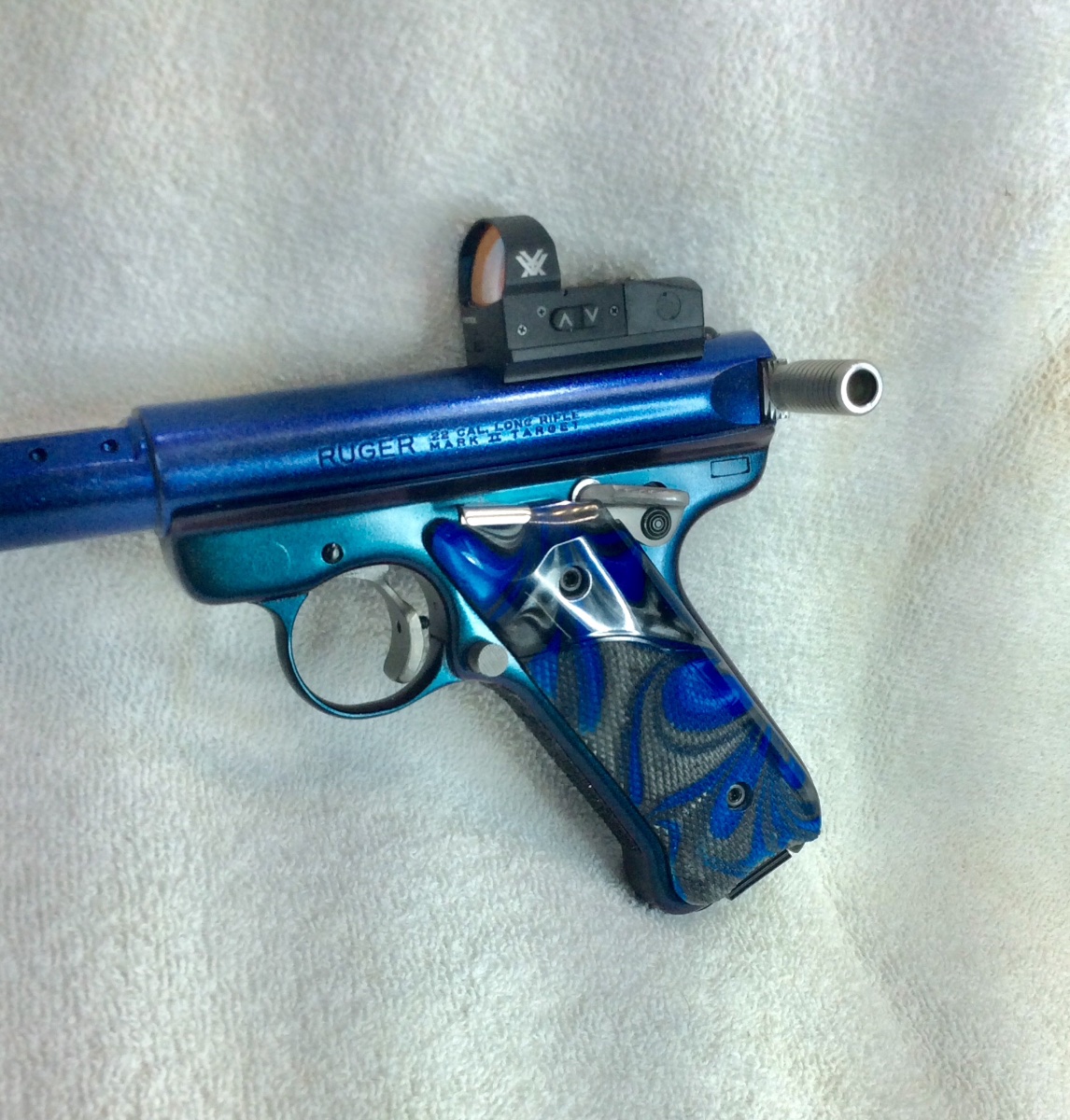

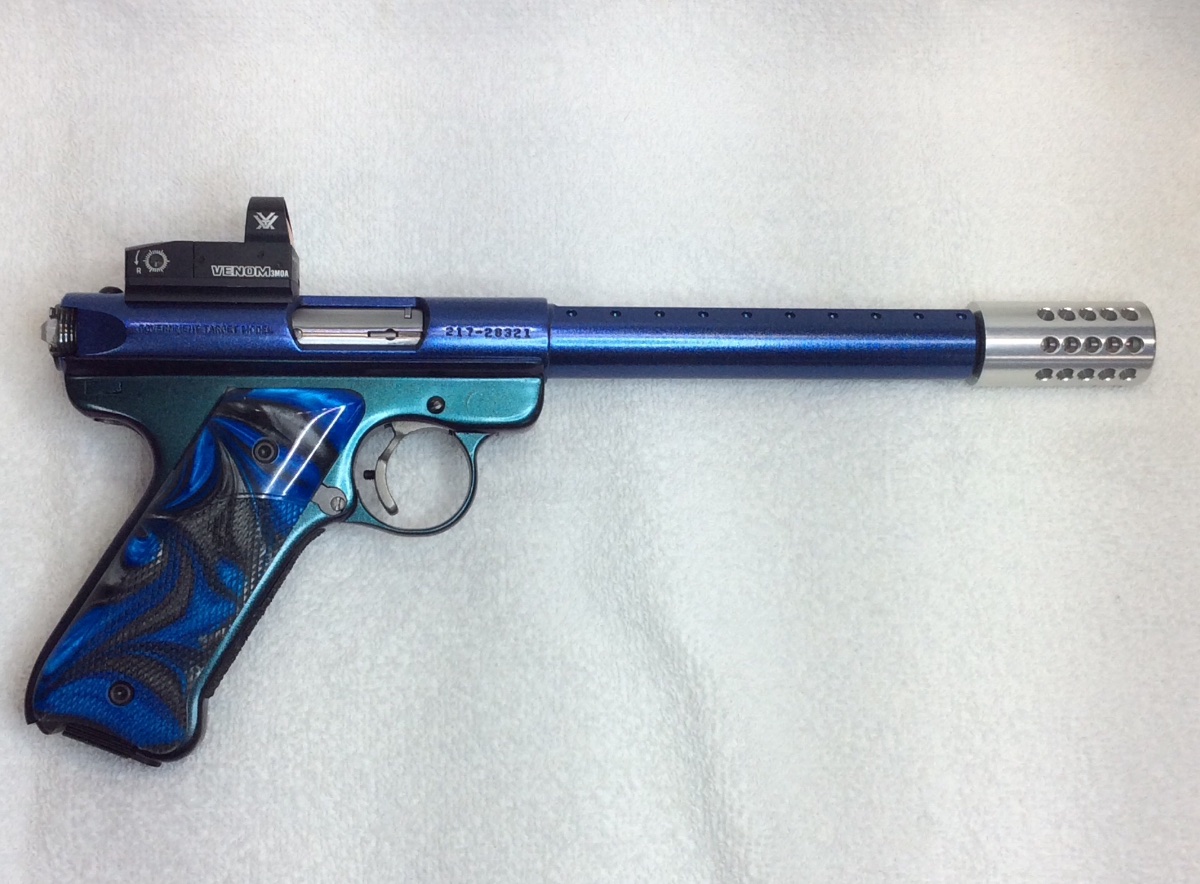

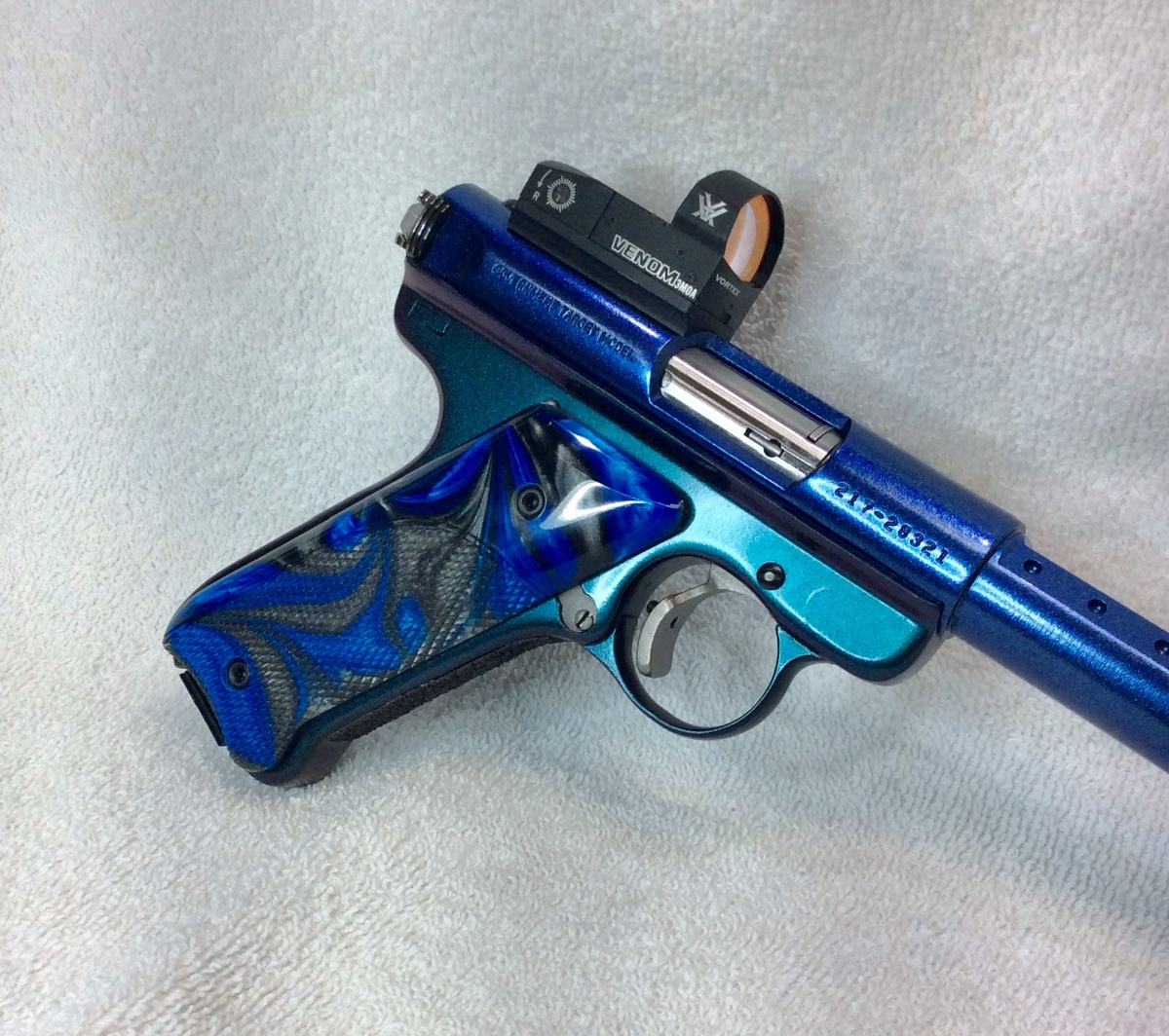

Well bill, here they are
It’s a MKII government target. And before anyone chastises me for butchering
A GT, the frame had already been modified and someone attempted to install
A rail on the receiver, so it’s collector value was gone when I got it and what a great
Platform to build from, right?
Yes, it’s a MKII, the mag release is a 1911 release! The barrel was milled and dimpled. Then
Threaded. All of the internals that can be replaced are volquartsen. As is the trigger, safety and bolt catch. The bolt is a MKIV that was dovetailed for a charging handle (my favorite part) and fitted with volquartsen extractor and firing pin. The mount for the vortex is a mad macs precision.
The comp is TacSol, And the last edition was the grips, custom done by lance schofield at LS grips. (He did the checkering in a pattern I requested, and had them to me in 3 days! Really nice guy too!
