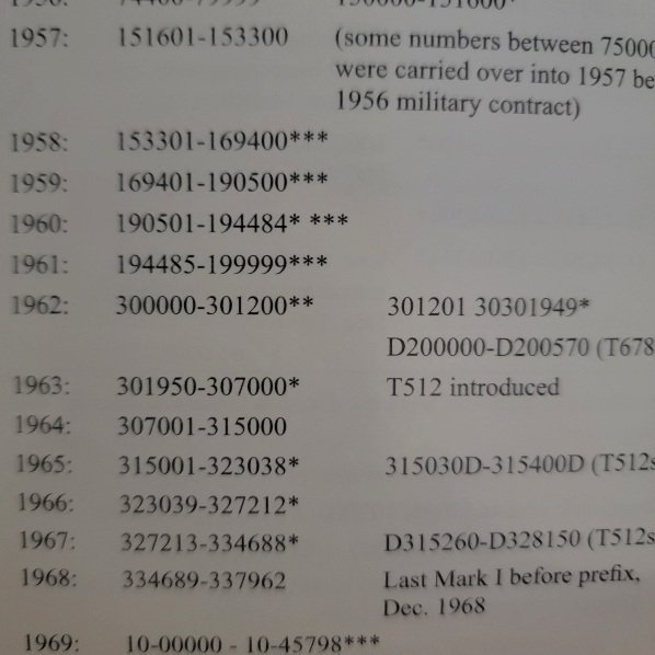

I have an early Mark I Target that I think was manufactured between 1962 and 1965. It looks to be a T678-W. I have gone through Mr. Hiddleson's "Encyclopedia of Ruger Semi-automatic Rimfire Pistols, 1949-1992" but can't get a definite confirmation/manufacture date for it nor confirmation it is what I think it is. Looked on the Ruger site but apparently they don’t have Mark I serial numbers available (anymore?). Any confirmation or other information is much appreciated, thank you.

Posts: 507
Re: Early(ish) Mark I Target questions
Dern Rick,,, you got me. I looked at the wrong chart. My info was on the Standards,, NOT the MKI targets.
My mistake. (And it's what I get for looking up something when tired.)
RPM's info is the correct info.
rpm enterprises
Posts: 204
Post by rpm enterprises »
From now on Ty I will be your backup. LoL. Hey I did just pick up 7 of those wranglers I've been looking for. And I did find one of the others I just need to call them tomorrow.

So this pistol having a serial number of 3012XX, that makes it 62?
If I might ask, what do the [*] and [**] (single and double asterisks) next to the serial number ranges indicate?

rpm enterprises
Posts: 204
* some targets are u.s. in this serial range ** both standard and target models in this range *** random blocks of numbers within standard models.
