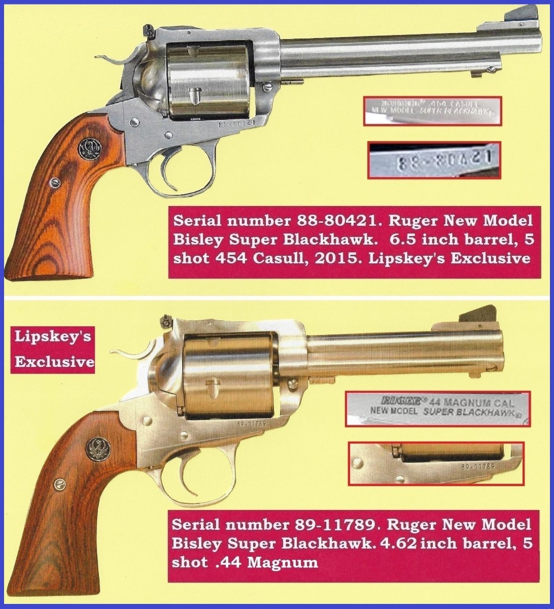

In the old models it is easy to tell a SBH from a Blackhawk. There are so many configurations of the Ruger New Model, I have to rely on Ruger's roll mark identification.
Posts: 1390
Re: Don! Question about a gun in your book
You would not know these were Super BHs unless you looked at the left side roll mark.

The one I was reffering to is on page 185 and 186 of your book. Says they are 1 of 1000 for Williams Shooting Supply. I can see nothing different on them that would make them a Blackhawk instead of a Super Blackhawk, they look exactly like every Super (in that barrel length) that I have ever seen! Other than they are marked Blackhawk! Weird.
Posts: 1390
I did not get a picture of the left side of the guns (page 185 & 186). I checked with the owner of the revolvers to make sure. He confirmed they were Blackhawks & not SBHs. The only way I could tell that they were Blackhawks and not Super Blackhawk, which is roll marked on the left side "RUGER NEW MODEL BLACKHAWK" and not Super Blackhawk.
