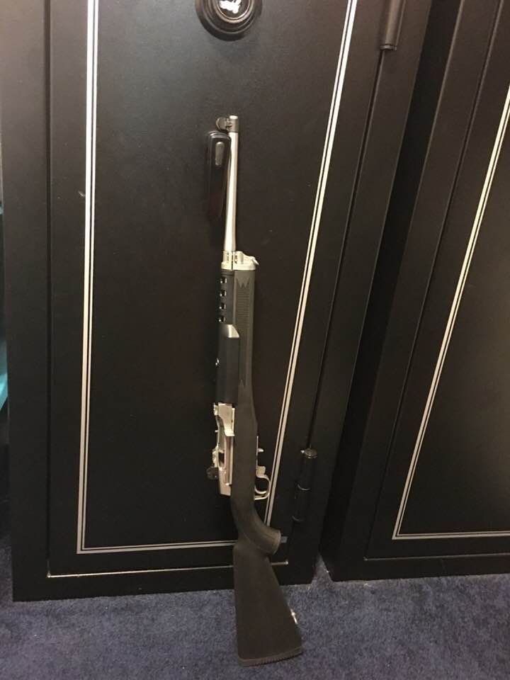

My Ruger Mini 30 7.62x39 rifle. 8-)

Nice!

Nice Mini-30. Fun to shoot.

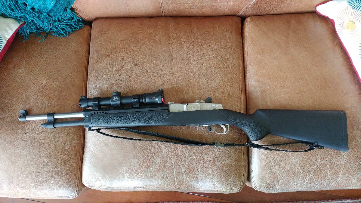

Here's my littlle zombie gun:

Cool looking Mini 30, I like the Scout scope look.

looks good

Thanks Guys,
Besides the Ulti-Mak forward rail with a Burris 2.7x long eye relief scope and the Accuracy Systems barrel brace, here are some other improvements:
A shock buffer guiets the action a bit and prevents shock damage to the receiver.
As you may know, a stock mini 30 slings brass into the next county. Some put a heavier recoil spring on, which works but then the action is very stiff and it's a pain to reassemble. The other solution is to install a reduced gas port, which is harder to do but worth it. Mine now drops cases about 10 feet away at about 2 o'clock. It also lessens the shock to the receiver.
I occasionally had to help the bolt forward into battery when firing. Drove me crazy until I discovered that most of the aftermarket 10-rd mags (Ruger didn't make one at that time) had sharp inside edges from stamping and were dragging on the tapered cases. Took a file to those and problem solved.
Shims, a lighter sear spring and a shoe have improved the trigger immensely. Must be about 2 lbs pull cuz it just needs a tap.
I recrowned the barrel at 11°. With all that the best I have been able to shoot is about a 4-inch spread at 100 yds. It's a little disappointing but still a blast to run.
By the way, I believe the best ammo for the money is Sellier & Bellot 123(4) g fmj. Lucky I just got a case before things went nuts. Again.

Owen, That is a good looking rifle. The work you did on it is interesting. I know about the fired cases being flung quite a distance with other firearms. The "Hot Brass Dance" has been done by many people including myself. There are lyrics to that dance but they are not printable here!

Thanks, again, Watertender.
I have way too much $$ in the gun. I forgot to mention the Hogue over-molded stock. And then there are the various sight options I tried before settling on the Burris. But hey, I'm having fun.
I sometimes get the hairy eyeball from the guy on my right at the range until he sees how it drops brass.

Way cool!!
Good looking gun.
I like the stainless look with the black synthetic stock.
