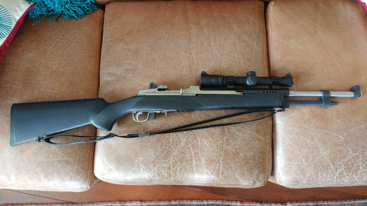

Here's my littlle zombie gun:
Re: Ruger Mini 30
Thanks Guys,

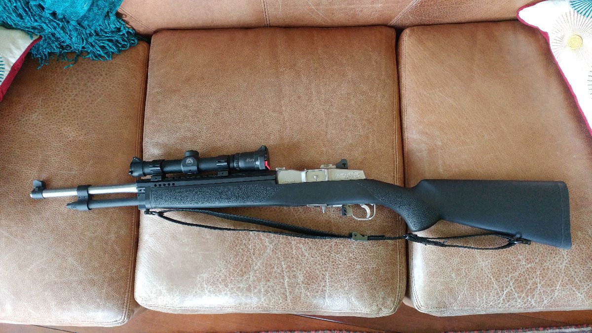

Besides the Ulti-Mak forward rail with a Burris 2.7x long eye relief scope and the Accuracy Systems barrel brace, here are some other improvements:
A shock buffer guiets the action a bit and prevents shock damage to the receiver.
As you may know, a stock mini 30 slings brass into the next county. Some put a heavier recoil spring on, which works but then the action is very stiff and it's a pain to reassemble. The other solution is to install a reduced gas port, which is harder to do but worth it. Mine now drops cases about 10 feet away at about 2 o'clock. It also lessens the shock to the receiver.
I occasionally had to help the bolt forward into battery when firing. Drove me crazy until I discovered that most of the aftermarket 10-rd mags (Ruger didn't make one at that time) had sharp inside edges from stamping and were dragging on the tapered cases. Took a file to those and problem solved.
Shims, a lighter sear spring and a shoe have improved the trigger immensely. Must be about 2 lbs pull cuz it just needs a tap.
I recrowned the barrel at 11°. With all that the best I have been able to shoot is about a 4-inch spread at 100 yds. It's a little disappointing but still a blast to run.
By the way, I believe the best ammo for the money is Sellier & Bellot 123(4) g fmj. Lucky I just got a case before things went nuts. Again.
Owen
