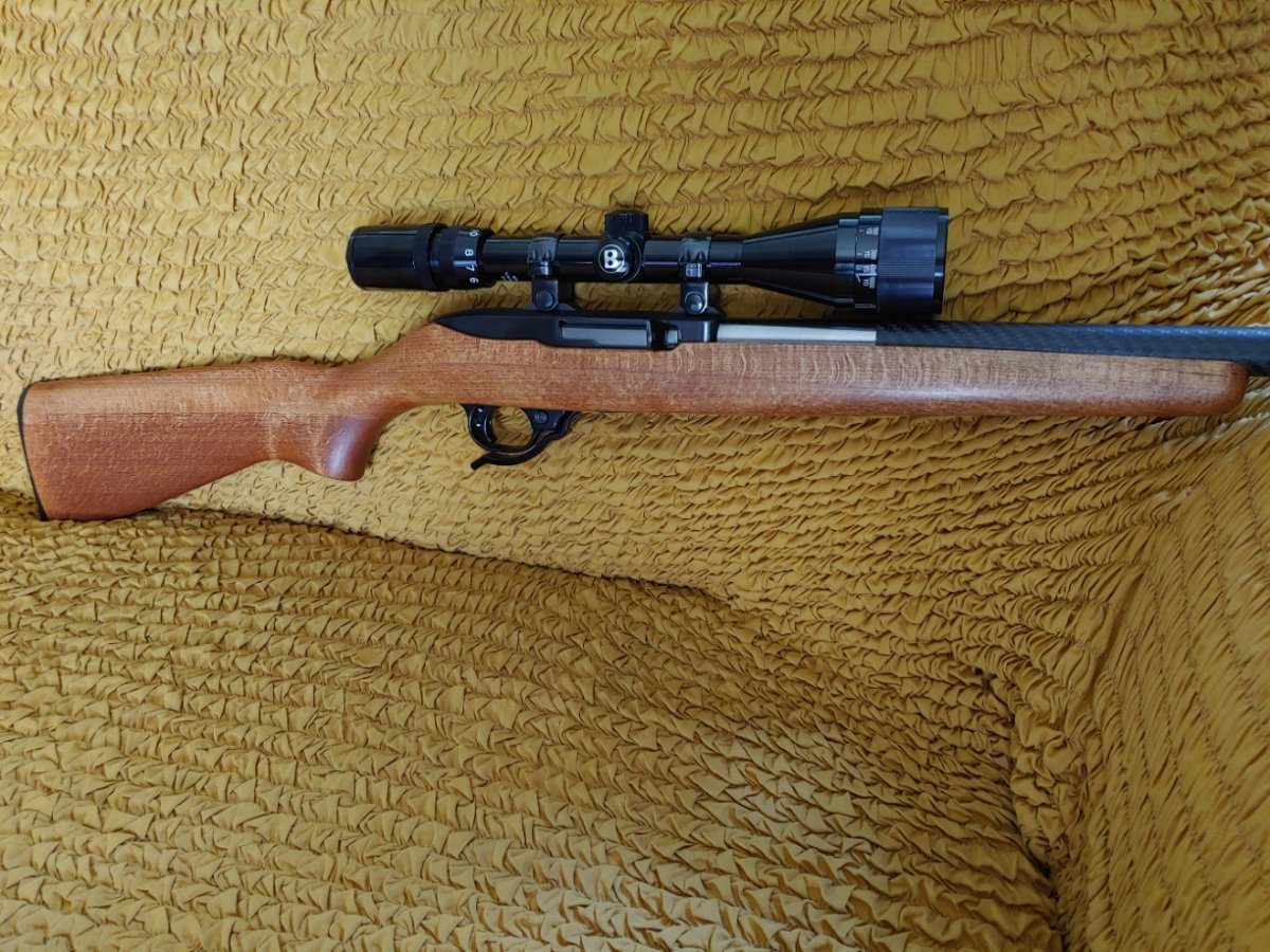

Got around to the refinish - man, that factory stain was laid-on heavy and it was hard to remove. Birch doesn't take stain like walnut so it has a light application of Minwax Gunstock 231 with a hand-rubbed linseed oil finish. Nothing like the look and feel (and smell) of oiled wood imho. The grain is exposed and some nice light-play is revealed. This slender stock is a pleasure to hold and the combo is a fun shooter, now. Some pics:
