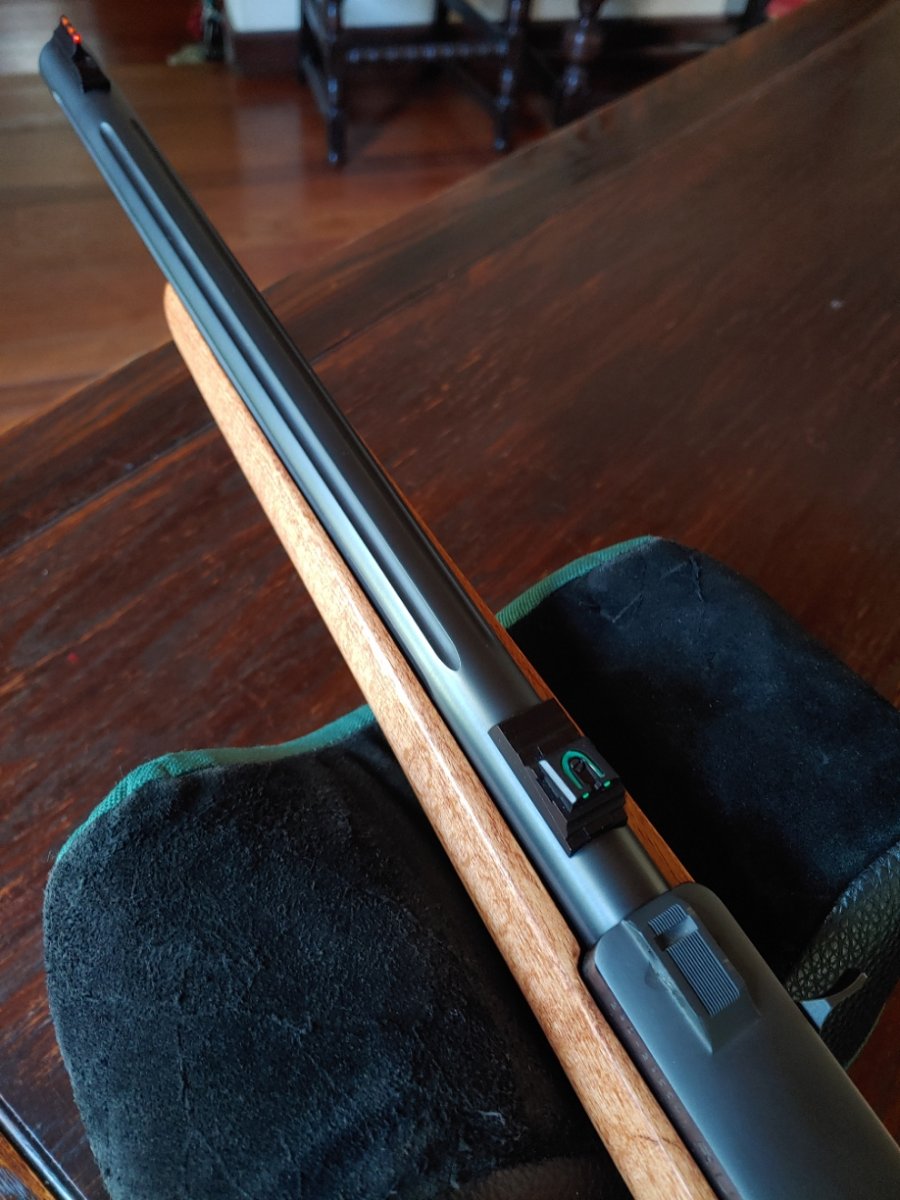

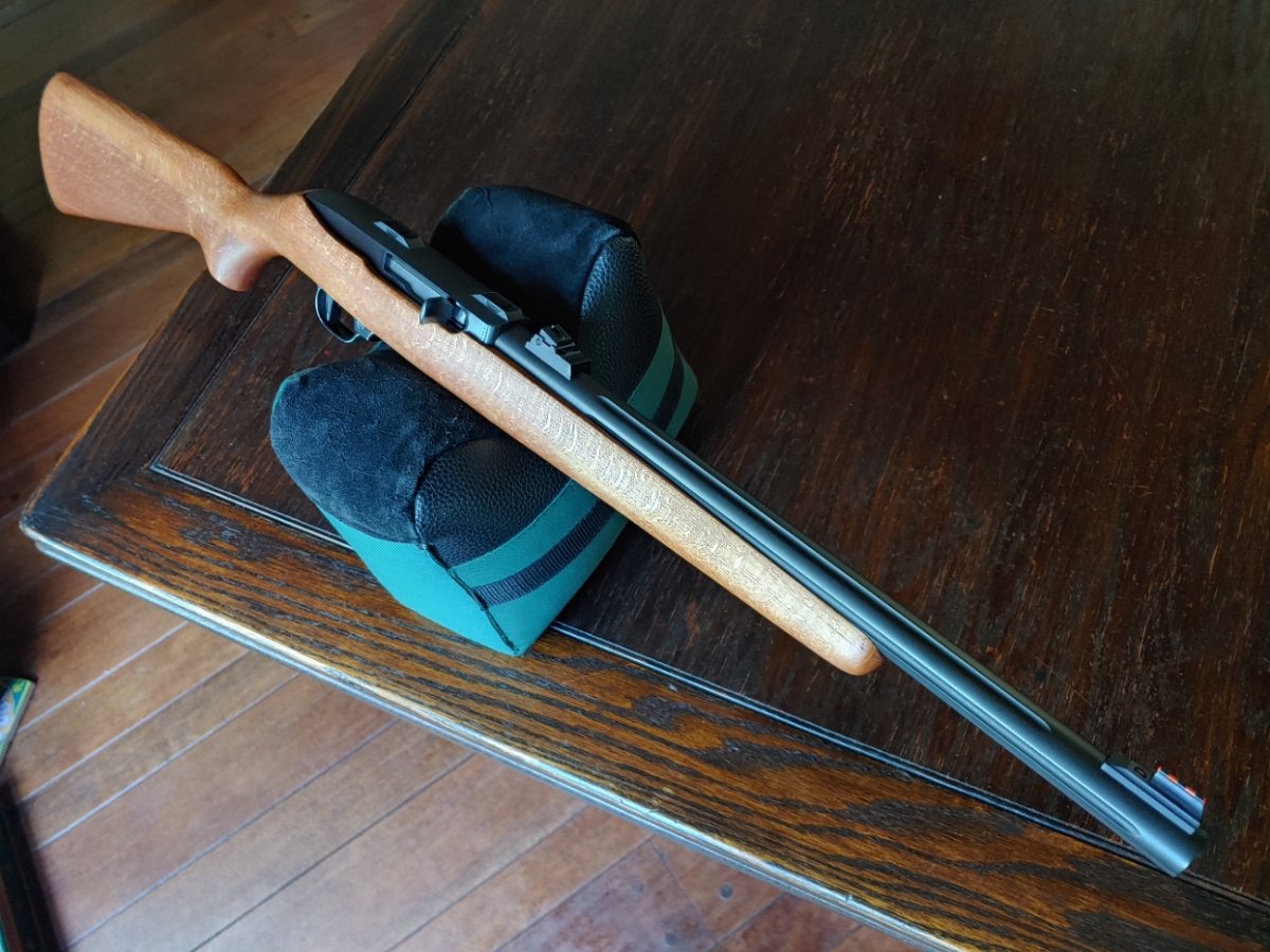

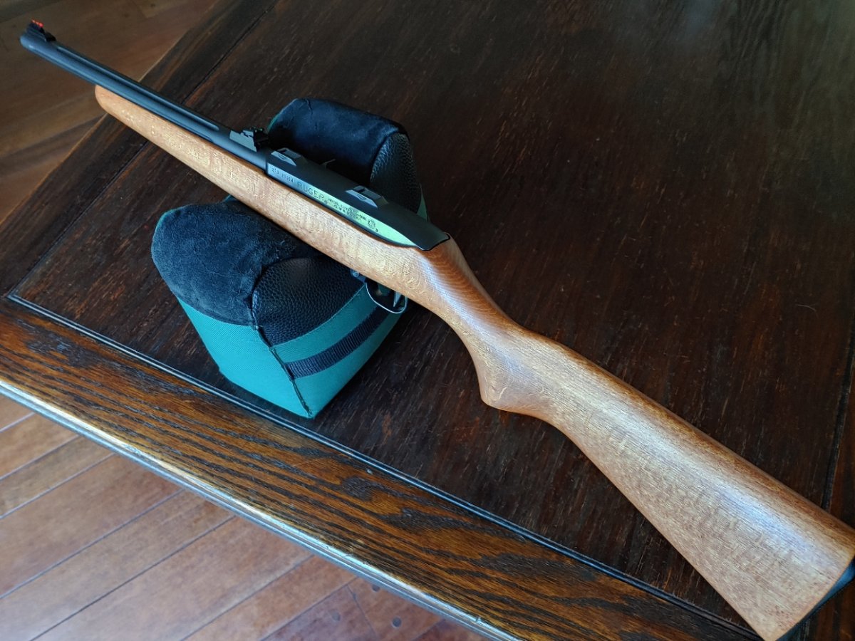

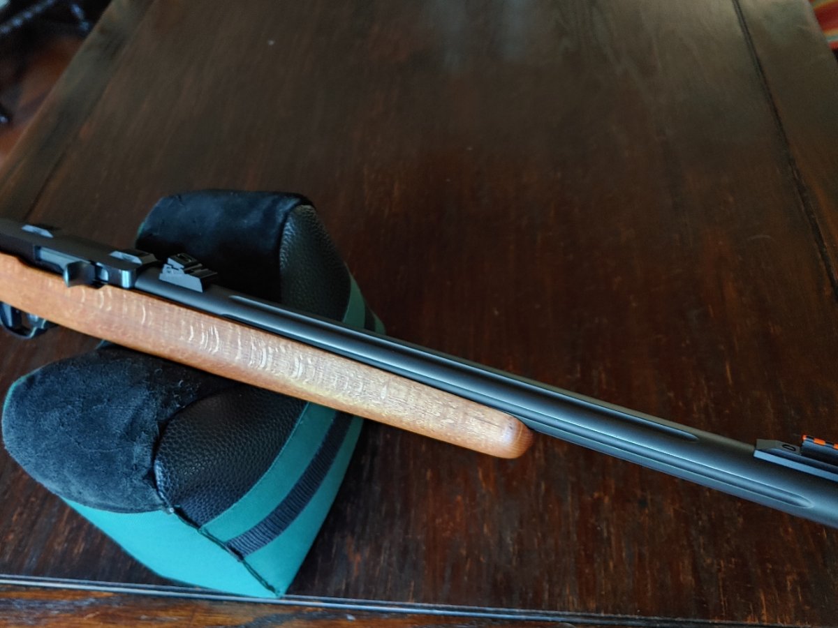

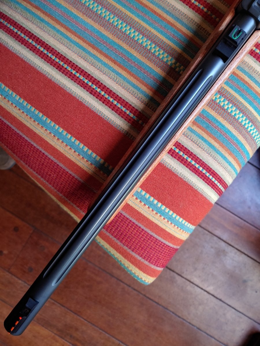

So, I already had this new FJF 16" fluted bull barrel and I just had to put it together with the Sporter stock that I stripped and opened up. I think it looks much better in this combination. Some photos:

Try some different ammo, that 22mag is much better than 3 inch @ 50 yards.
Unless you are like me, to old to shoot up to the capability of the gun! :)
Jay

Well, boys, my eyes are certainly going funny and I suspect they're tired of working after all these years. That and rushing a short range visit, trying to do too many things, may have contributed. I've had good results with Fiocchi ammo in other calibers; maybe it's the "indoor range" bullet.
I like the contrast of the lightened stock finish against the blued barrel. It's handsome and unique though a tad heavy.
